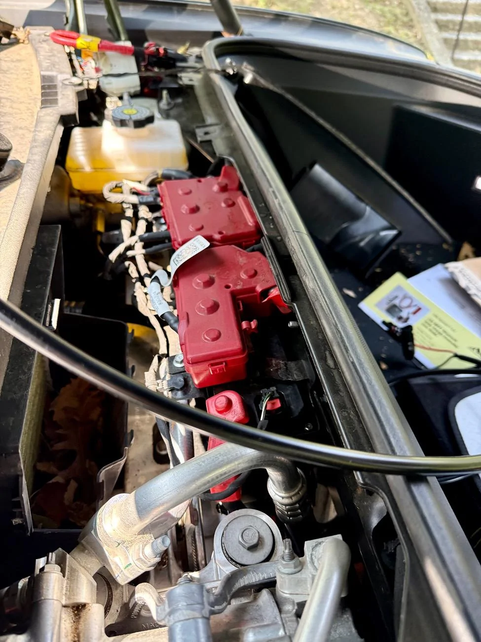

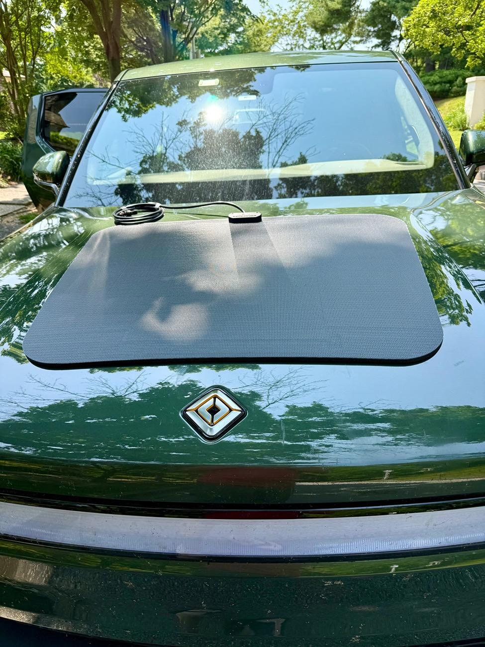

I’m installing a Cascadia 4x4 solar panel on my hood (Gen 1 R1T). The plan is to use it to charge an auxiliary LiFePO4 battery in the frunk, then use that to keep the AGM topped up with a DC to DC charger as well as providing auxiliary power for things like a powered cooler without hitting the 12V system too hard. I got the panel installed, but when I opened up the trim to expose the battery, I think it turns out that I have a dual battery system, instead of the single battery plus capacitor that I’d assumed based on my later delivery date (November ā€˜23). I didn’t want to fully disassemble everything yet, so was just trying to get a look, but it sure looks like there’s two batteries in there, under the two red boxes. Unless the capacitors they use are nearly an identical form factor to the batteries?
It’s been a while since has been a topic of discussion, so I guess I’m a little rusty in the differences in the wiring. Does anyone have a good diagram of the two kinds of systems, and what the best way to wire up a charger would be for either setup?

Capacitor is identical size to battery. That picture is a single battery with capacitor.
The difference is the passenger side one on the rear passenger corner with the red rubber. The dual battery model has black there instead of red.
So the unit on your passenger side is a capacitor and your single battery is on the driver side.

Oh good! I don’t know why, I just assumed the capacitor would look noticeably different…

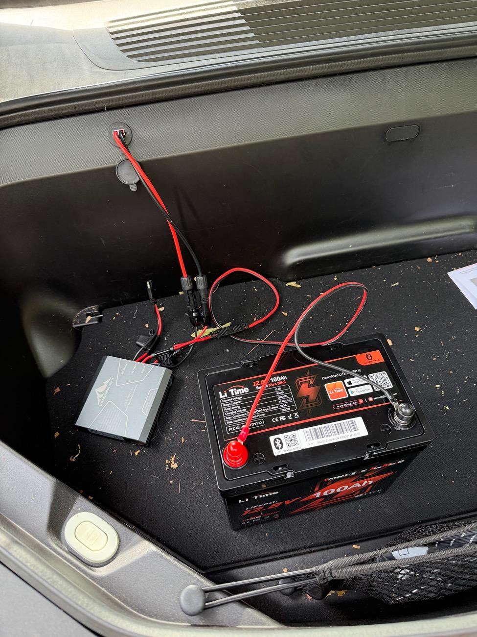

Well, I’ve got the Cascadia panel on my hood, and have run the wiring into the frunk. I’ve successfully used it to charge a secondary lithium battery, so now just need to get it wired to the truck battery!

A couple of questions. It doesn't look like Cascadia makes a Rivian-specific panel - which one is yours? Also, I understand that the solar panel is advertised as being for the hood, but could you have itl do double duty by placing it on the glass roof instead? Understand that makes running the wiring a bit more tricky.

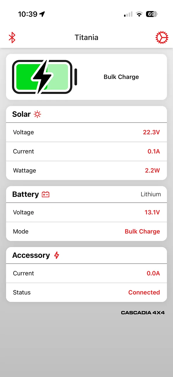

The panel I have is one they’re developing for the Rivian. Don’t know if it’s on the site yet. It’s a 92W panel, and seems to work well (I didn’t pay attention when I was screenshotting the app, that low current is not representative of performance…)
I suppose you could mount it to the glass roof. The install process involves putting on a vinyl decal that has cutouts where you use adhesive to mount their ā€˜SolarClasp’ attachment points, that are kinda like a super heavy-duty Velcro. I think that if I wanted to install a panel on the roof, I’d probably instead go with a rigid panel mounted to the crossbars. From there it would be pretty easy to run the wiring either into the cavity where the power tonneau goes if you don’t have one, or even straight into the gear tunnel, which gives you easy access to the cabin. Not sure how the 12V outlet in the gear tunnel is wired, but probably wouldnā€˜t be too hard to re-wire it to go straight to the battery so you could use it for charging. Since I’m planning on having a secondary 12V battery in the frunk, I’m thinking of attempting to rewire all the accessory outlets to that battery, so they can be always on without worrying about killing the main 12V battery.
