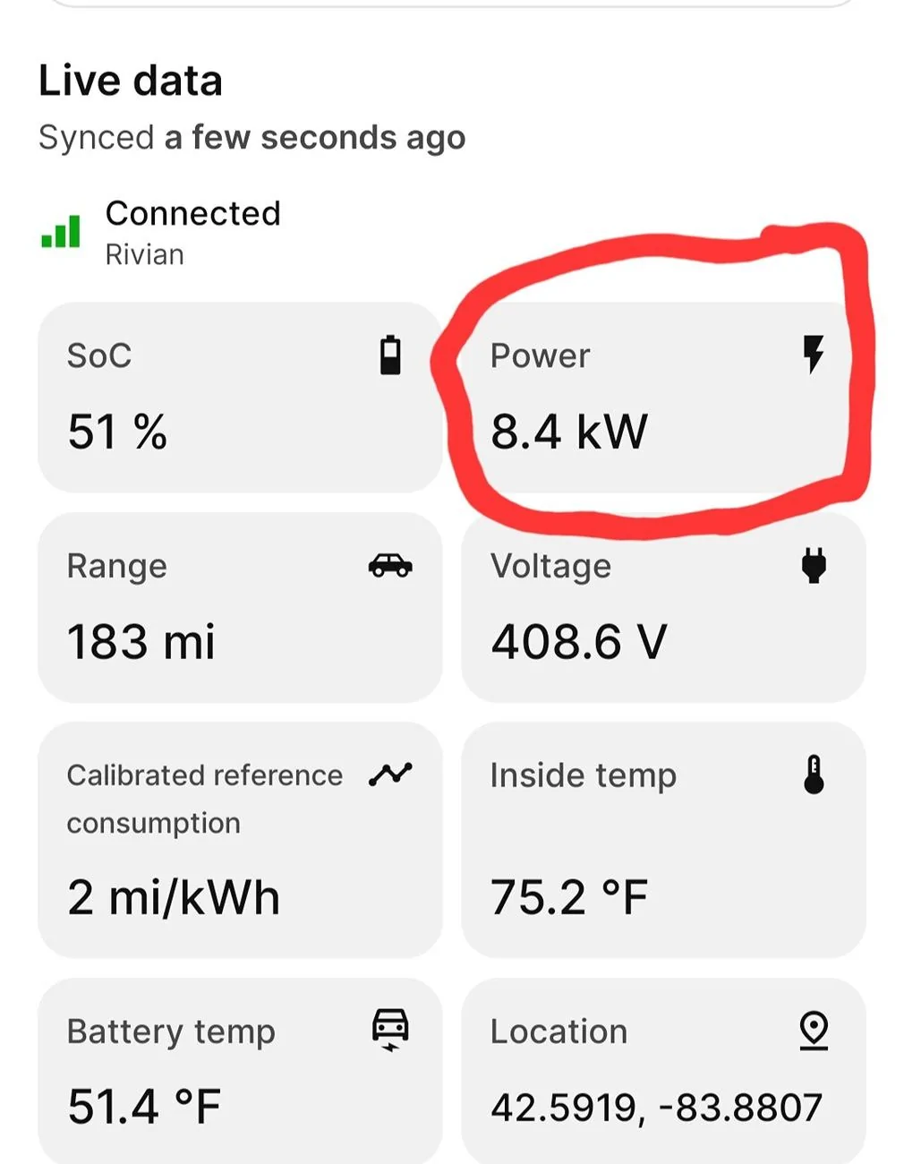

Can we just look at the power draw in ABRP to compare?
Gen 1 R1T Large pack with the heat cranked to max.
Ok so the savings, if regular driving is ~40kW, could be about 10% with the heat pump. That is actually pretty material. I would still prefer the resistive heater but 10% range is not nothing.
