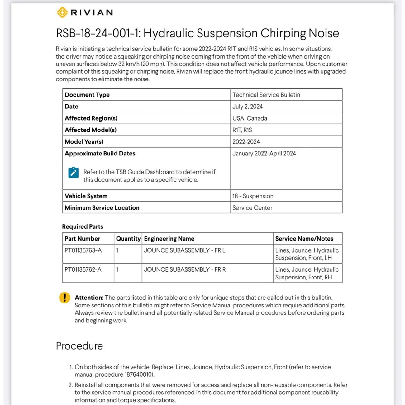

I think it’s quite rare to get a complete suspension upgrade (I.e. all dampers and air springs, front and back.) Many people got the jaunce lines replaced per the atttached service bulletin. The service center will do that upgrade if you ask, but you’ll likely need to demonstrate some serious problems with your suspension for them to do much more than that.
