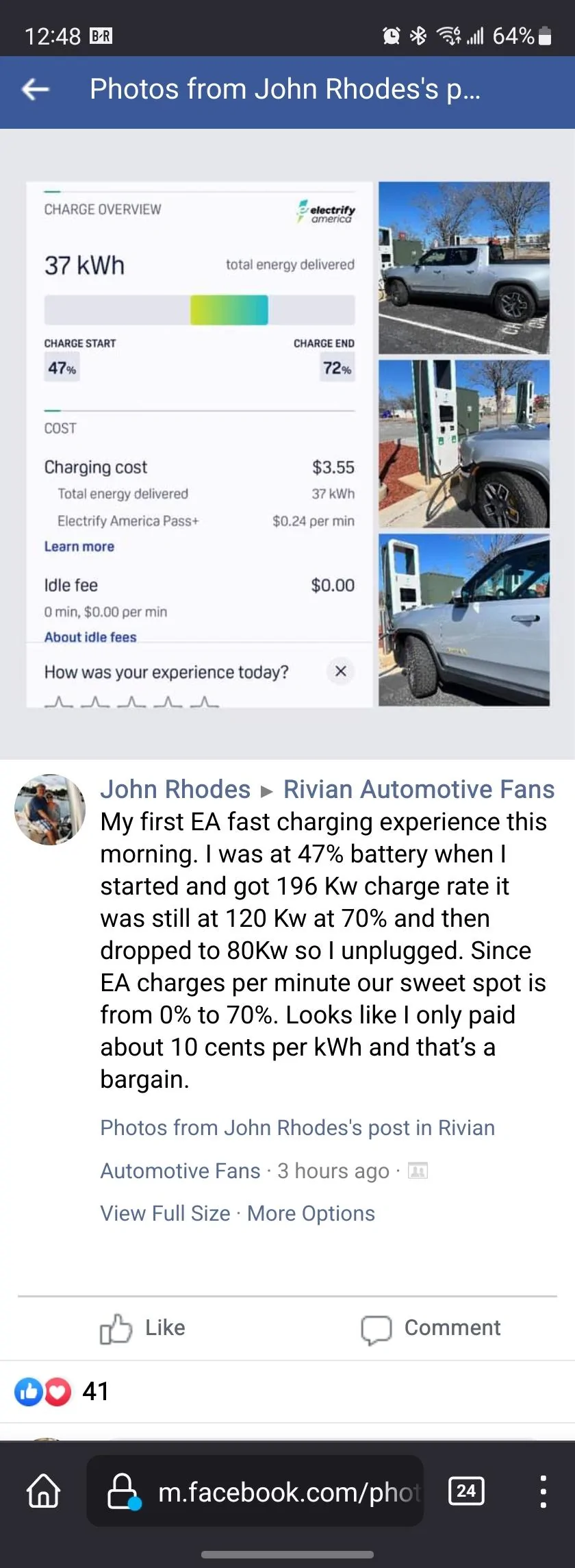

And then John get 196kw at 47% and 120kw at 70%. Which is more what I'd expect. You haven't been able to replicate this, right @OutofSpecKyle ?
Rivian R1T R1S Initial range and charging real world observations by R1T owner Screenshot_20220320-124830_Firefox
