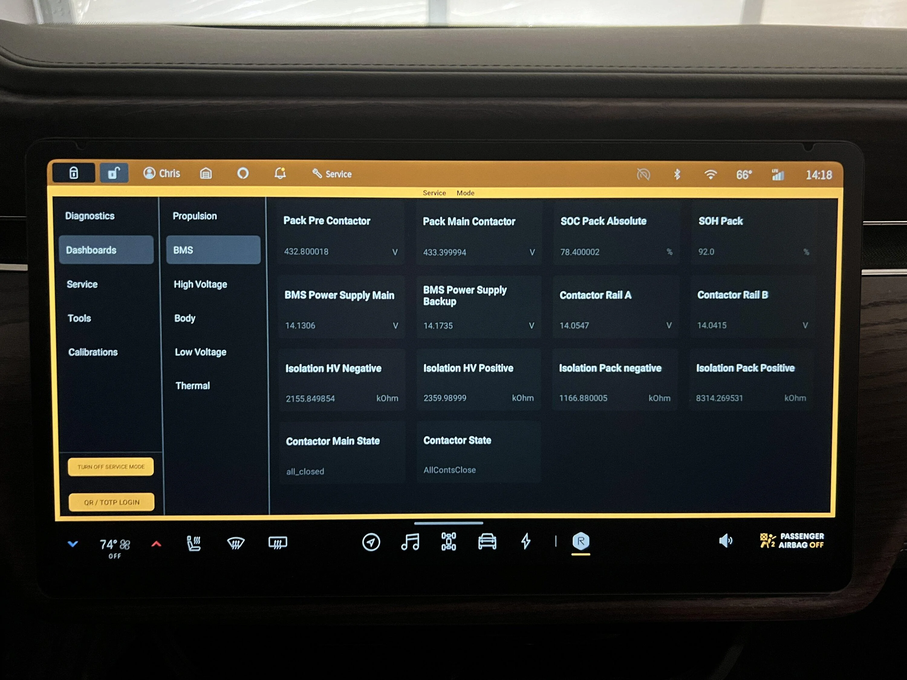

I just took a look at my SoH after 1 year / 13K miles -- 94%

92% SOH
28k miles
Location: SoCal
Times Fast Charged: <12, and then at least 10 of those were between 20-80%.
This is my 3rd BEV, so I'm familiar with charging.
When new there was only the 70/85/100% sliders, I left mine at 70% SOC. I have only full charged the truck twice, once was ~98% literally went on a road trip, didn't have time to wait. So I never let the truck sit at a "high" SOC. Now my daily charge is 80%, I have a ~53mi daily commute, 50mi is freeway.
I'm confused why my SOH is so low, compared to others, especially Kyle who is at 95% @ 37k, and he fast charges A LOT. Maybe all my highway driving, high rate of speed?
I home charge 99% of the time, and it never sits above 80% SOC. I do use the Rivian L2 11kW Charger.
Still love my truck!
Rivian R1T R1S Latest RiDE Menu Code IMG_3178

x12000 VIN
92% SOH
28k miles
Location: SoCal
Once again, we don't know what this number means relative to each truck, the fleet, the specific battery, or really any other metrics of age/max charge/temp ranges/charge cycles.
Until a Rivian engineer reveals the equation, it's useless to speculate.
