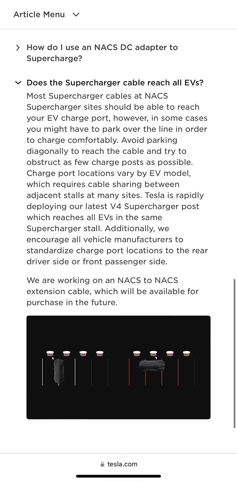

Tesla is working on making their own extension cable as well.
I plan to get one from Tesla and A2Z to compare the difference between both and will end up keeping one in my frunk.

I wouldn’t get an extension cord for DCFC. That’s just a life-death disaster waiting to happen
This.
A lot of unanswered questions, although I did not investigate so maybe there are answers. DCFC fast charger cables include cooling and temperature sensors in the connector for obvious safety reasons. Extension cables have neither.
Based on my use case, it's unlikely I will ever charge at a Tesla station. If I do, I'll deal with any parking space challenges that might arise.

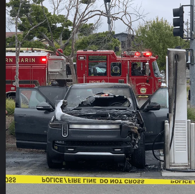

Is that a real picture ? & do you know where and what happened

Anecdotal. The charger is not a Supercharger. And no extension cable was used. It was at a EA wasn’t it? While Elon is associated with Tesla, not all funds paid to Tesla goes to him. Tesla does employ thousands of Americans, who are not working pro bono.
Patronage to Supercharger gives other networks competition, like EA, which prompts them to do better. Understandable reaction, but irrational to avoid Supercharger out of spite for one man. To boycott Tesla is like refusing to pay HOA fees because you don’t agree with just one neighbor. We don’t live on private islands. All is connected.
