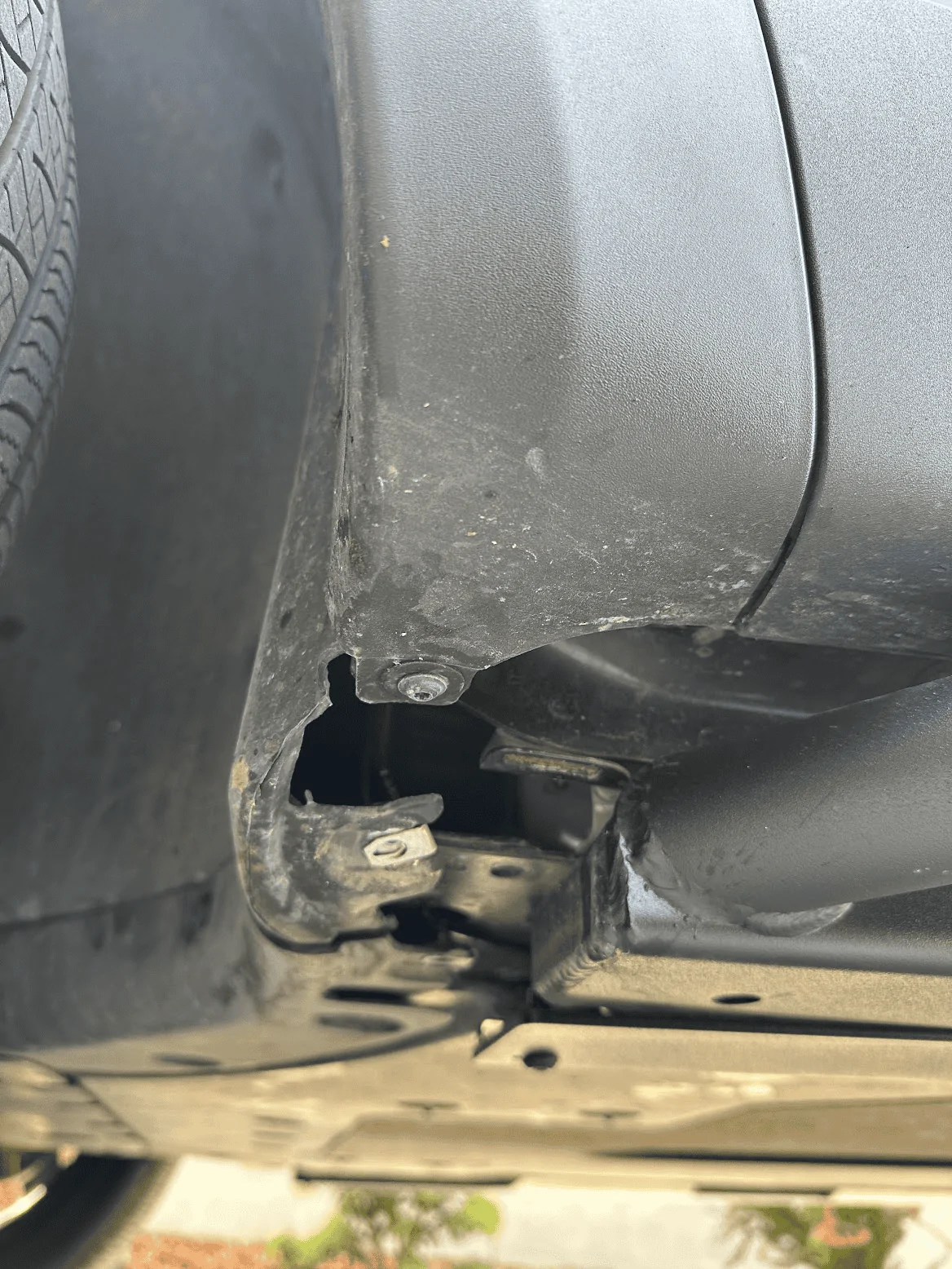

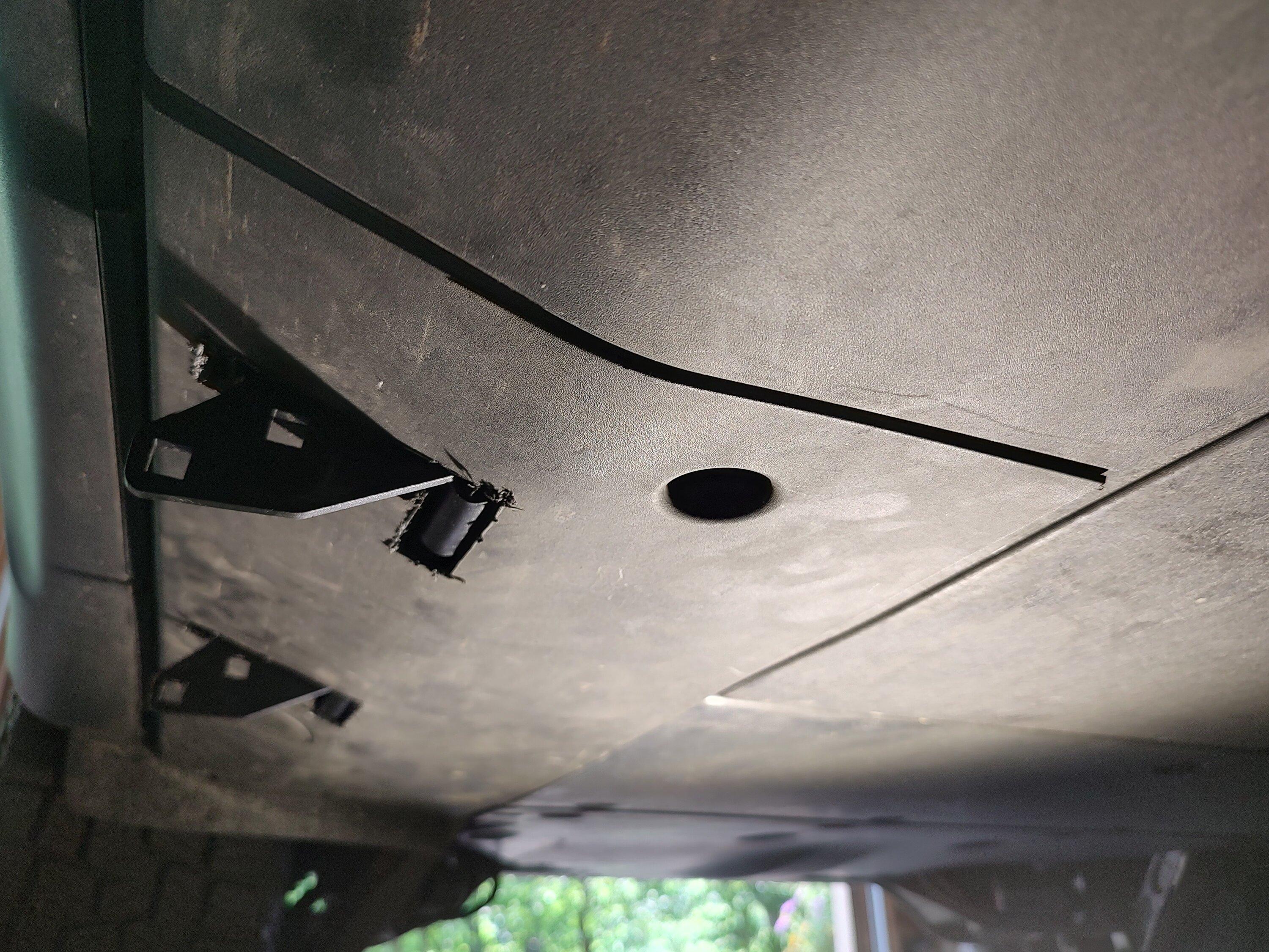

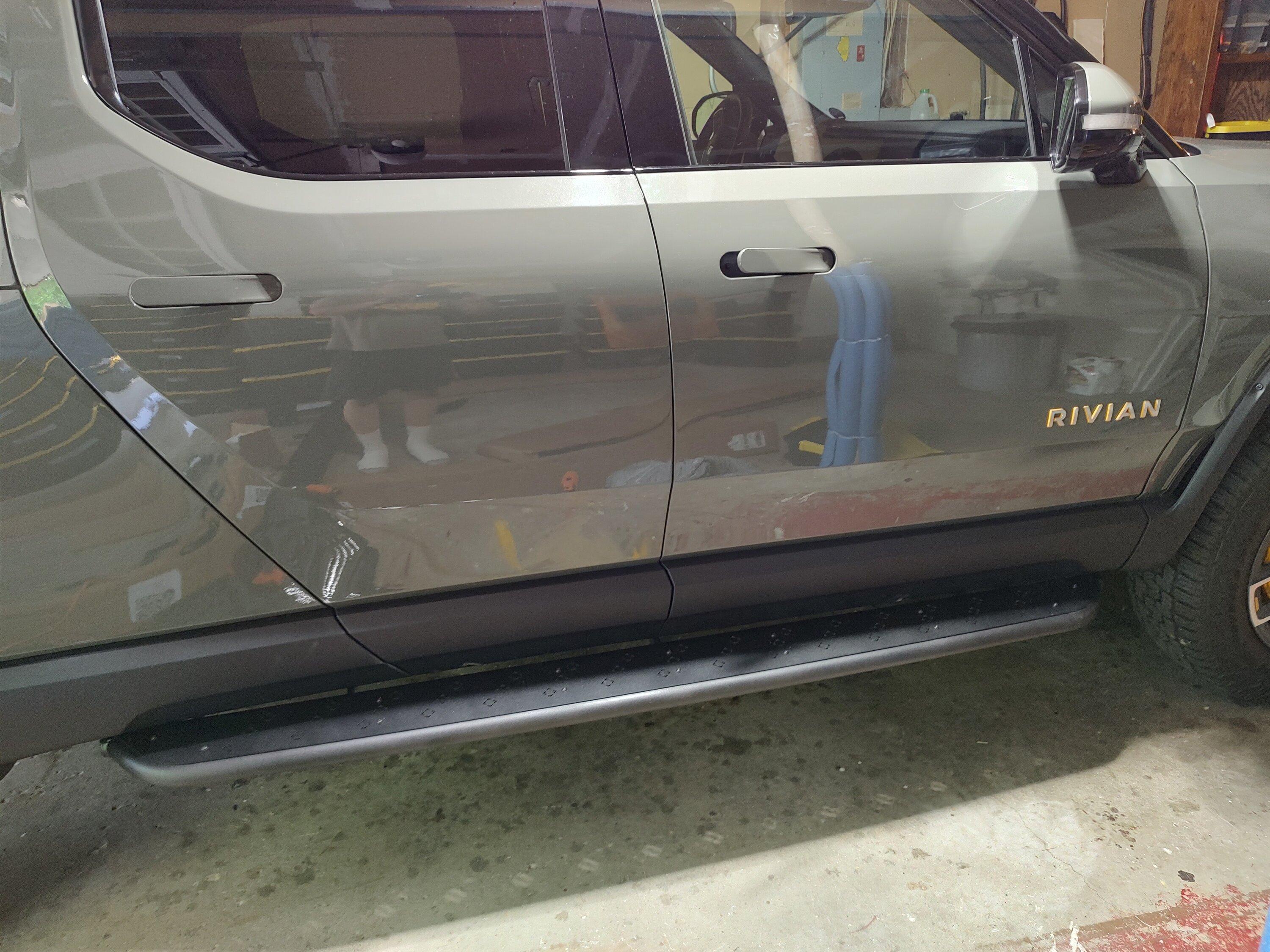

I did my install today. Decided to go with the slot method which in the end I'm glad I did because two of the brackets did not fit right and I had to grind them down to fit around other bolts in the frame. Took me about 5.5 hours total mostly solo except when mounting the actual running boards. They look and function great.
1 hr - unpacking and attaching plates to running boards (so much to unwrap)
2.5 hrs - Passenger side. I added an extra step since you need to torque down the T55 bolts before putting the panels back on and then attach the boards. Steps - (1) remove 3 panels. This took a while as I was way too gentle with the clip removals (2) remove t55 bolts, (3) attach brackets and snug fit t55 bolts. Attach running board. (4) torque down T55 bolts. Doing this with the boards attached will keep the brackets in line. (5) remove running boards. (6) cut out L shape holes for bracket access. I went very slowly and meticulously on this step remeasuring and holding up to truck to make sure it was right (7) re-install the 3 panels. (8) attach and tighten down running board.
2 hrs - Driver side. This was faster since I was able to remove the panels a lot quicker and trusted the cut outs even though I had to spend some time grinding out slots on two of the brackets to get them to sit flush. (one of them pictured. I kind of butchered the other one so I didn't take photo evidence).
This is not hard to do even with the L cut-outs. Just takes some time.

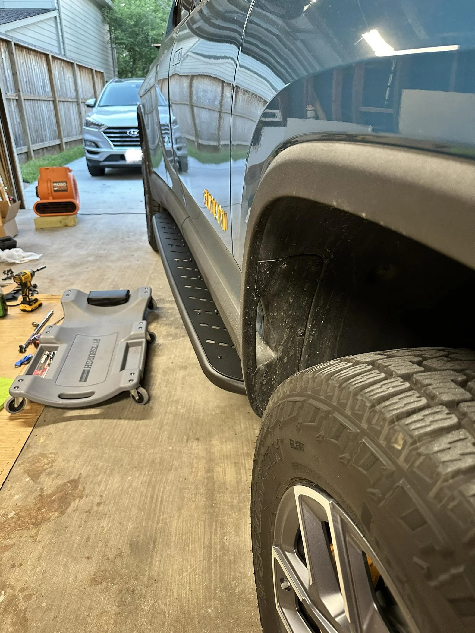

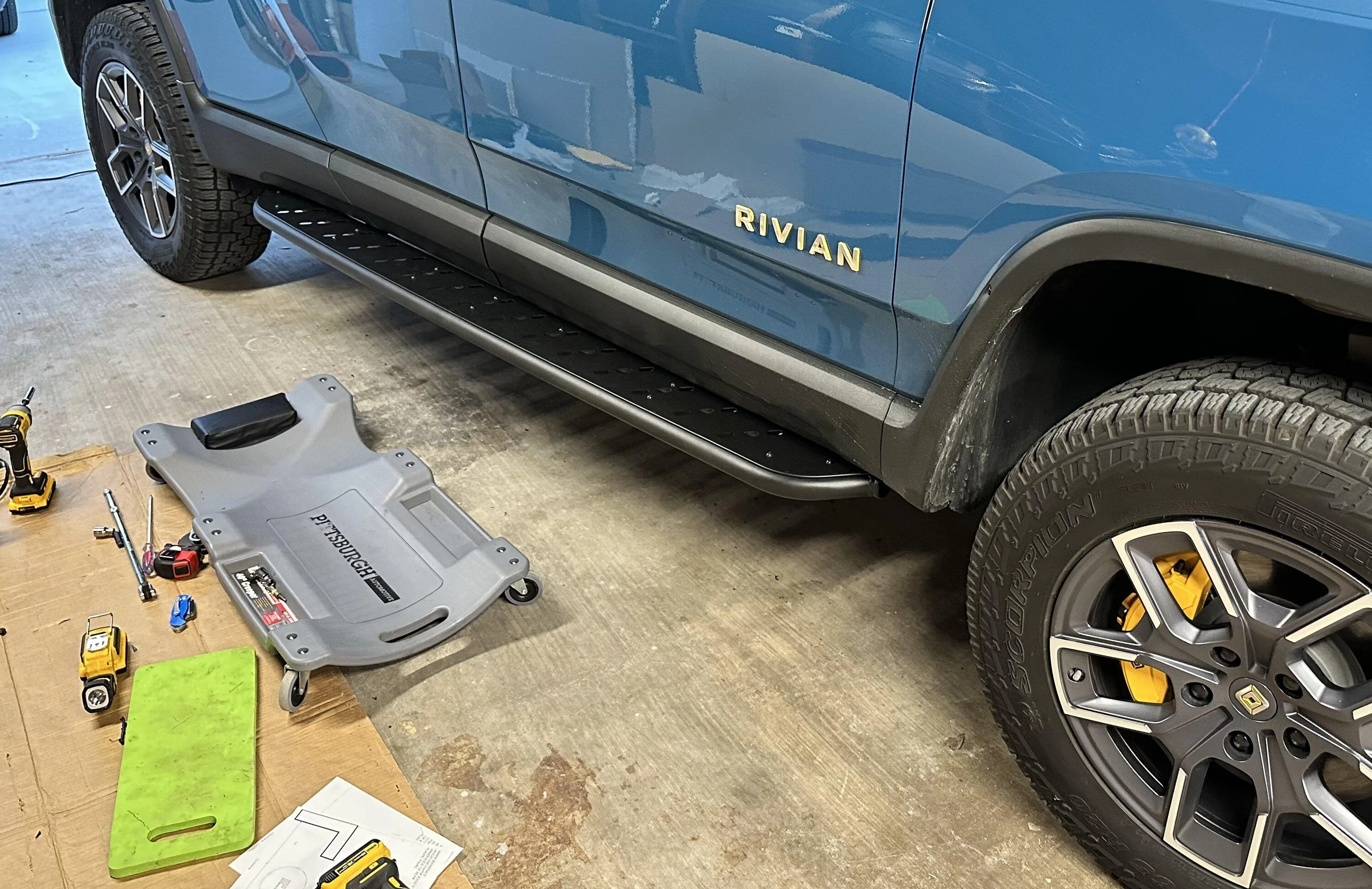

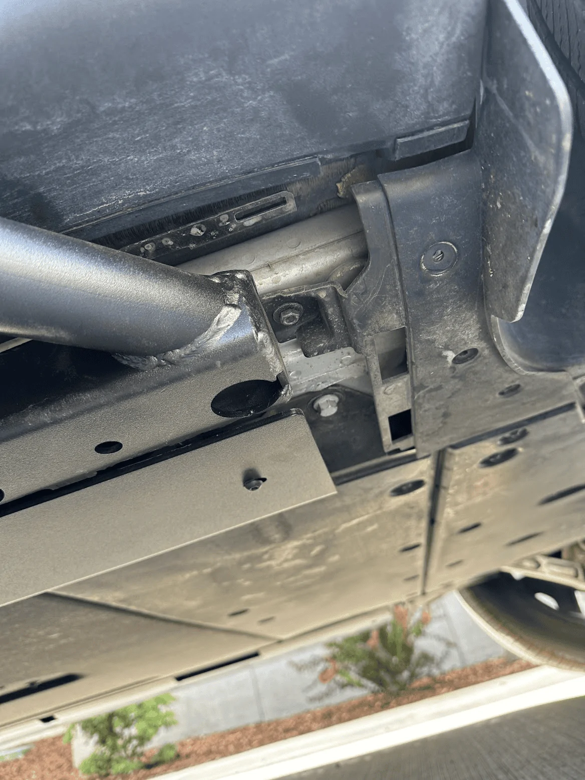

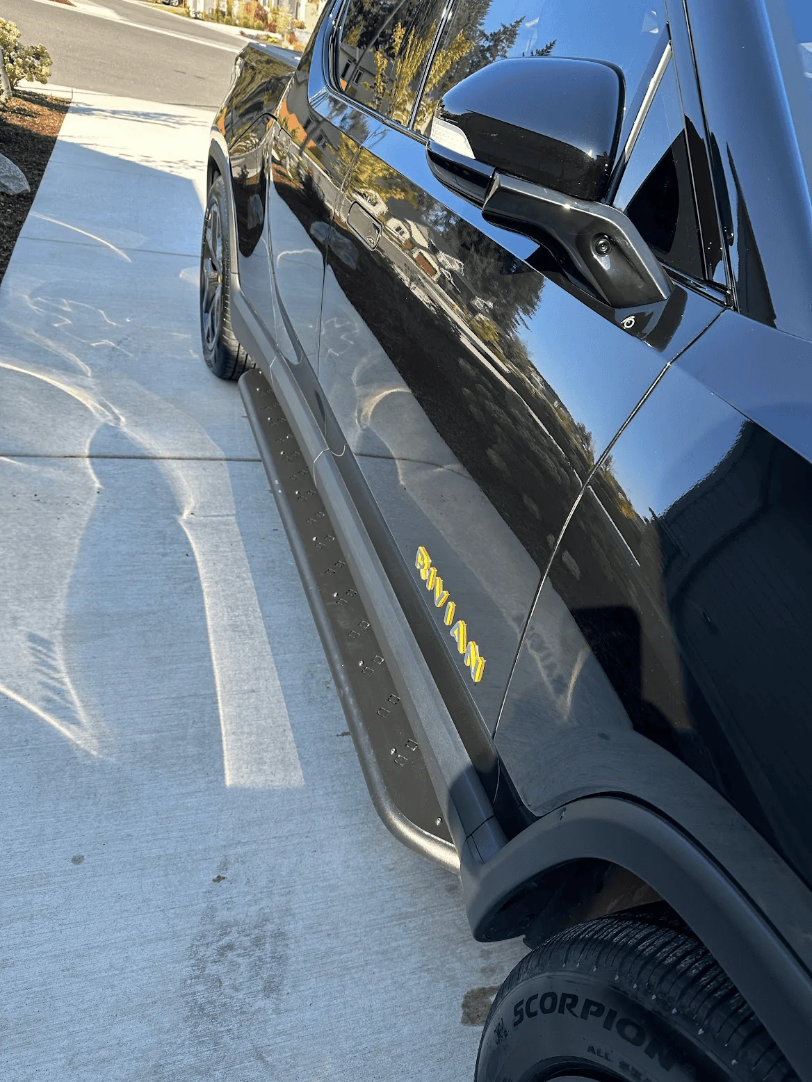

One side done with modified L slot cuts! 4 hours so far, but that is due to me being slow as I’m by myself, I’m doing a modified L slot cut, and my garage is literally 105 degrees. I owe no one an apology for taking an action photo with the tool mess lol. Do you spy the welting mod too?

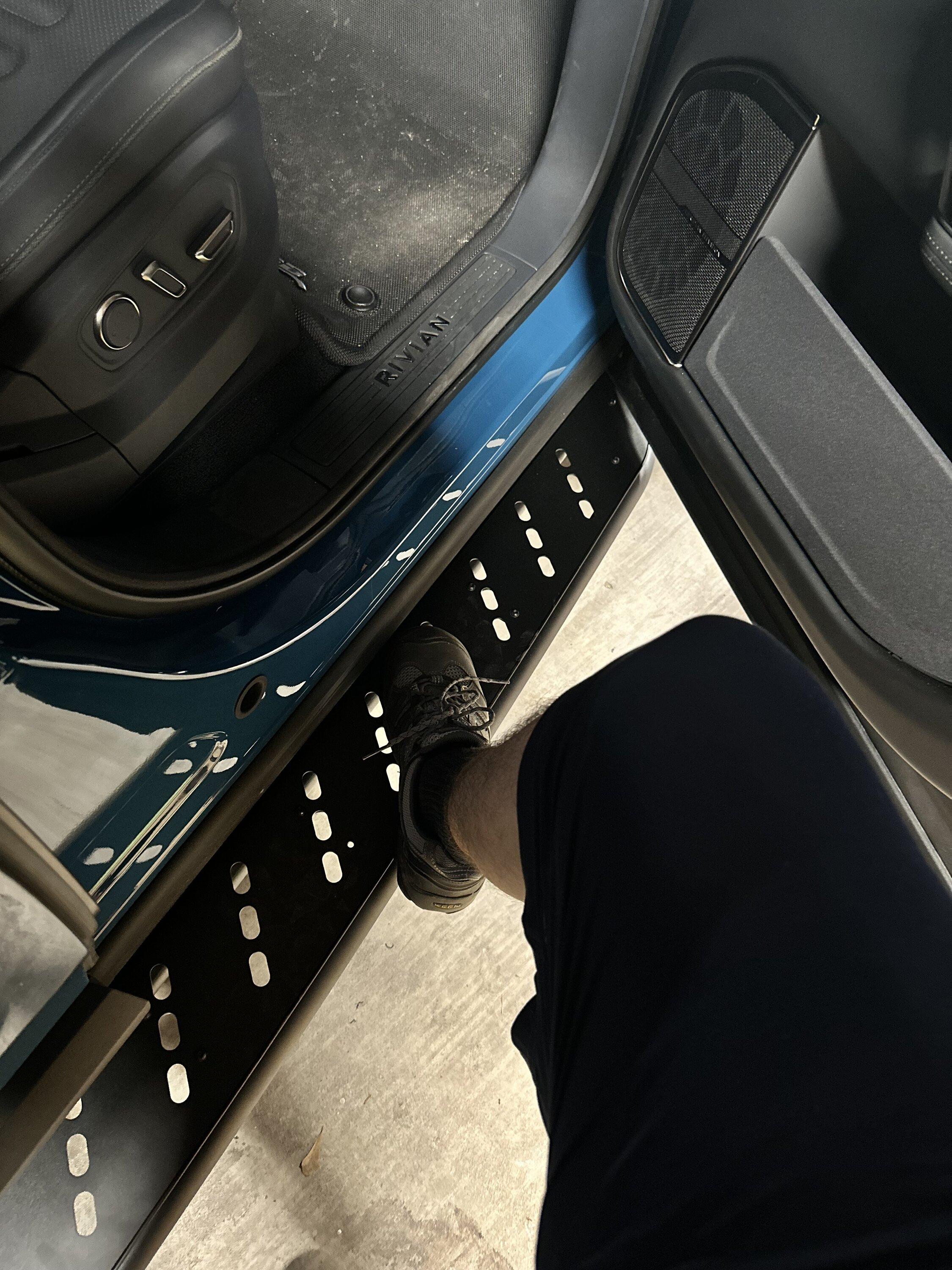

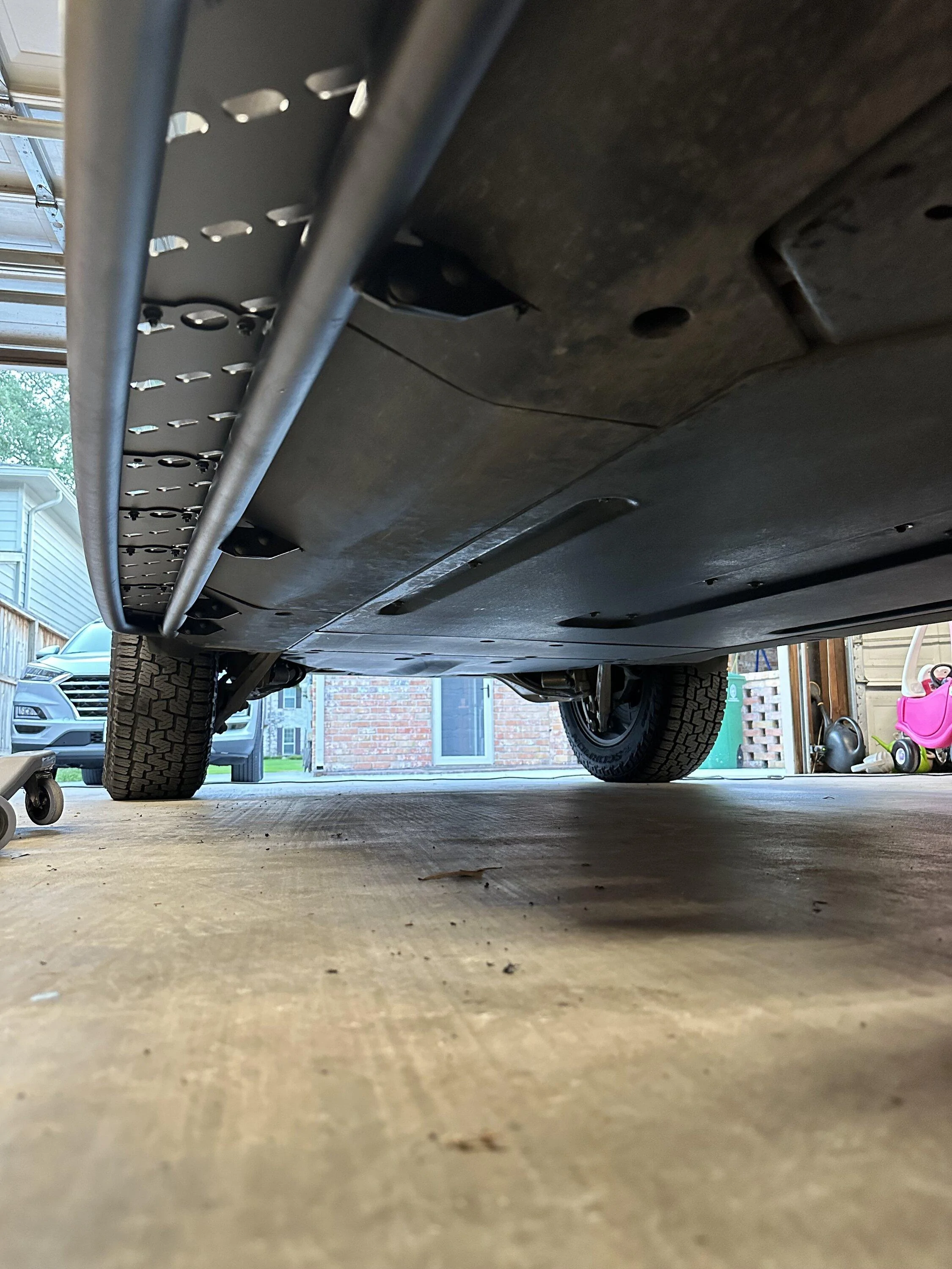

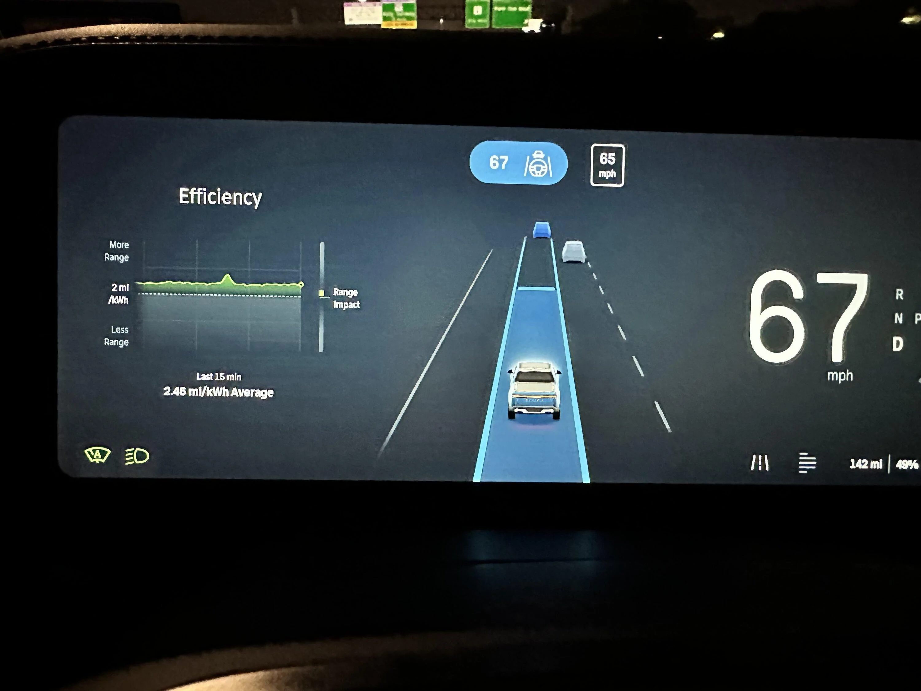

FYI in case any one is curious. My puddle lights are only slightly cut off when pushed all the way in. Hardly noticeable. Also efficiency does not seem to have taken much of a hit from my non-scientific test on a flat road with the 20’s.
Yeap. had it for a month or two now. Definitely don't see any range decrease with it.
Love the "Triple Slot"! Yeah, not measurable change to efficiency. All good!

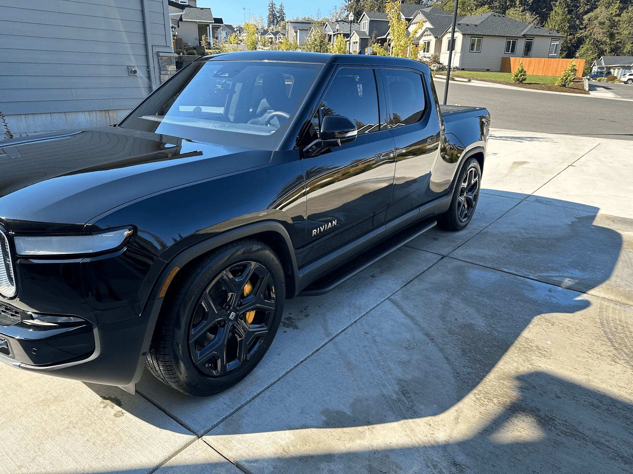

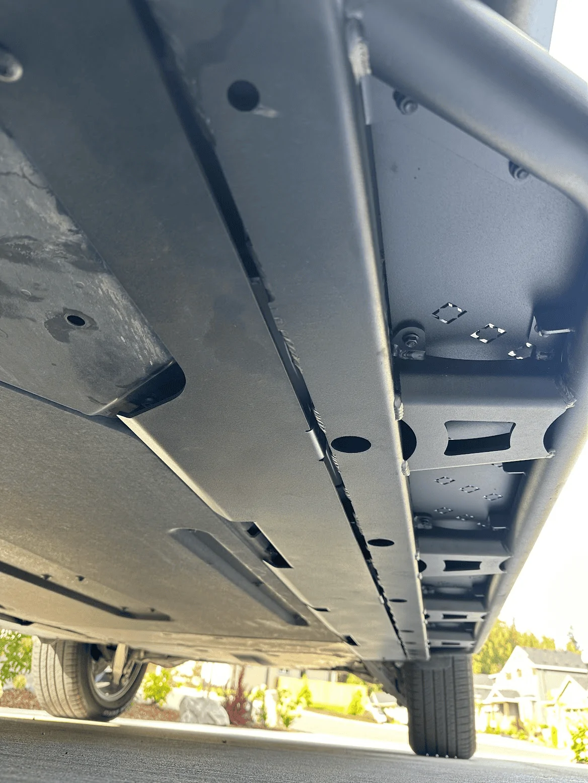

Sliders installed, overall happy with the quality. Will have to decide if I want to cut the factory plastic panels to fill in some gaps in the front and rear.
Rivian R1T R1S Master Thread:  Review of the EV Sportline RMaxx Running Boards/Sliders (from Team 1EV) 1695425513593
Rivian R1T R1S Master Thread:  Review of the EV Sportline RMaxx Running Boards/Sliders (from Team 1EV) 1695425533178
Rivian R1T R1S Master Thread:  Review of the EV Sportline RMaxx Running Boards/Sliders (from Team 1EV) 1695425609041
Front gap
Rivian R1T R1S Master Thread:  Review of the EV Sportline RMaxx Running Boards/Sliders (from Team 1EV) 1695425584757
Rear gap
Rivian R1T R1S Master Thread:  Review of the EV Sportline RMaxx Running Boards/Sliders (from Team 1EV) 1695425556808

Sorry if its been asked, but has anyone installed the boards w/o the plastic piece instead of cutting it? Has anyone figured out what that plastic piece actually functions as?!?! Is it for aerodynamics or protection? If it's neither, why didn't Rivian just eliminated it and save cost that way.
