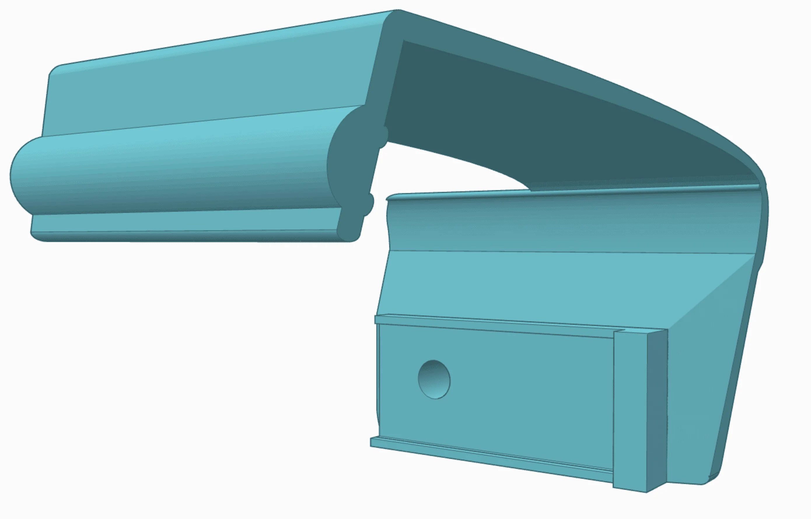

@RWerksman - love the left mount, as it’s been great for a few weeks, but it’s now seeming to be loose from the portion that goes behind the top of the dash trim due to the hot weather. Any advice for fixing this issue? Thanks!

Please contact me via the form on OpenSourceEV.com. I'd like to see what you're seeing - there are few things that we can look at.

I double checked the anchor and it looks properly seated to me. The part that hooks over the dash doesn't seem to be able to quite reach behind and underneath. Perhaps there is some slight size variation between trucks? Also wondering if the hook portion is even needed, have you tried a version without it? Seems like with the screw tightened it would hold in place fine without it.
I have the same issue. At first it wasn't a problem, but then after a bigger bump or two, the weight of my phone would be enough to pull the mount down to where the back bracket would come undone.
I solved it by putting a small bit of foam (with adhesive on one side) that I mounted to the underside of the thin dashboard 'strip'. Conveniently it was left by Rivian service in fixing some rattling. This foam helps provide enough friction that the mount can't slide down.
Not an official fix but it's worked really well and I can't tell the difference.

I'm seeing this more than I want to and I have a slightly tweaked update for folks that have a, "look at the size of that lad" phone on the left mount:
Rivian R1T R1S NEW - RIVIPARTS Left Side Phone Mount 1685916285408
I have a few of these out in test now to good feedback so far. If you're having issues with it slumping, please contact me using the "Contact Us" form on OpenSourceEV and reference this post.
Assuming it works out, this will be the default for the larger diameter models soon, and the 17MM model after that.

Thanks for the great customer service. Just shot you an email with my order number. Mine slumped to the point that it broke the rear tab. iPhone 14 max pro.

Happy to help! I've posted a bit more about this on the site, but everything (now including the 17MM version) is shipping with the slightly tweaked design and in material. I've been producing them in-house and I'm really thrilled with how they're turning out.
