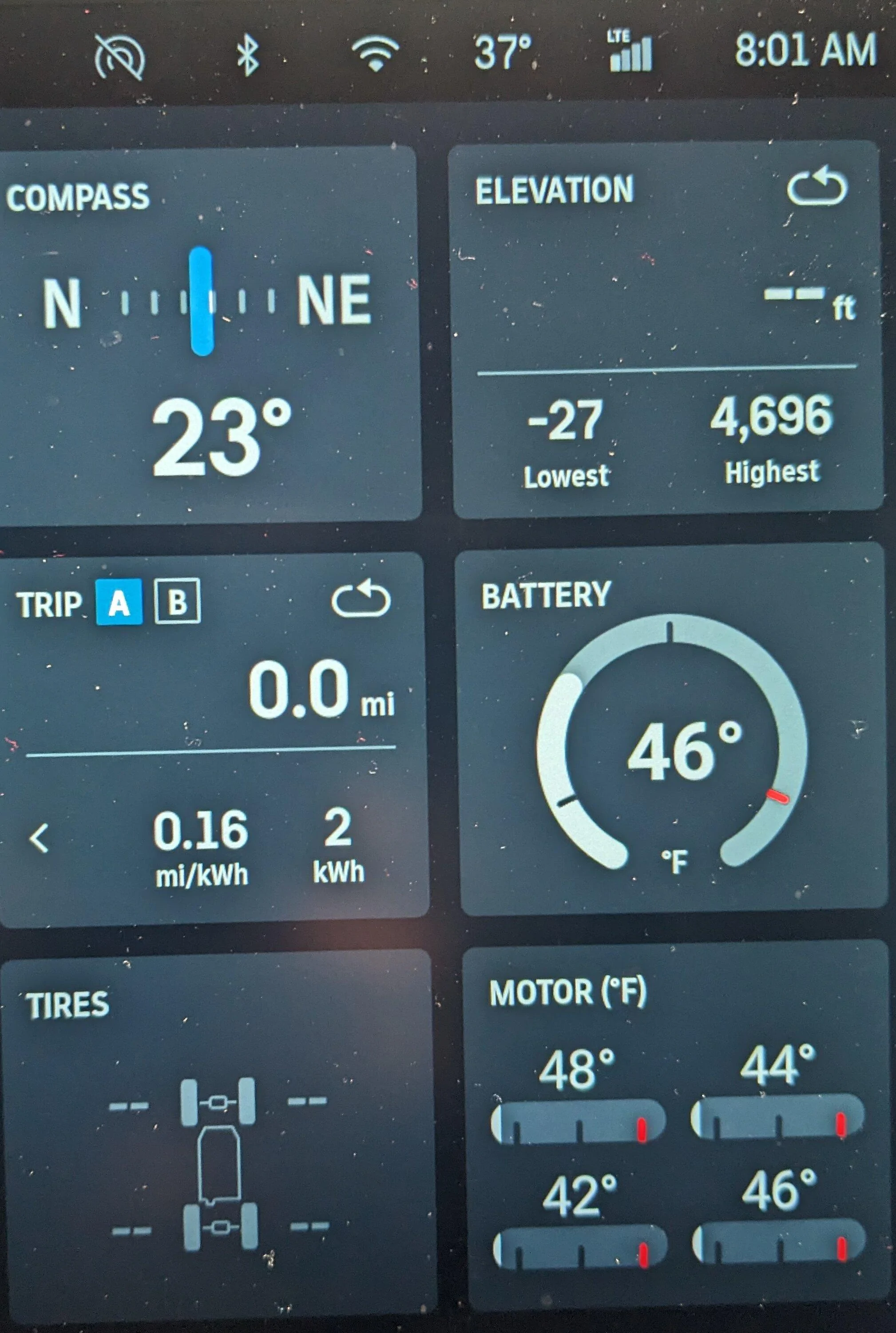

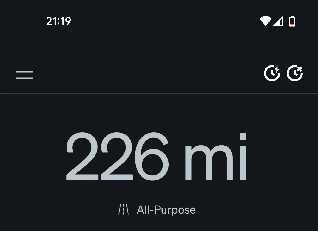

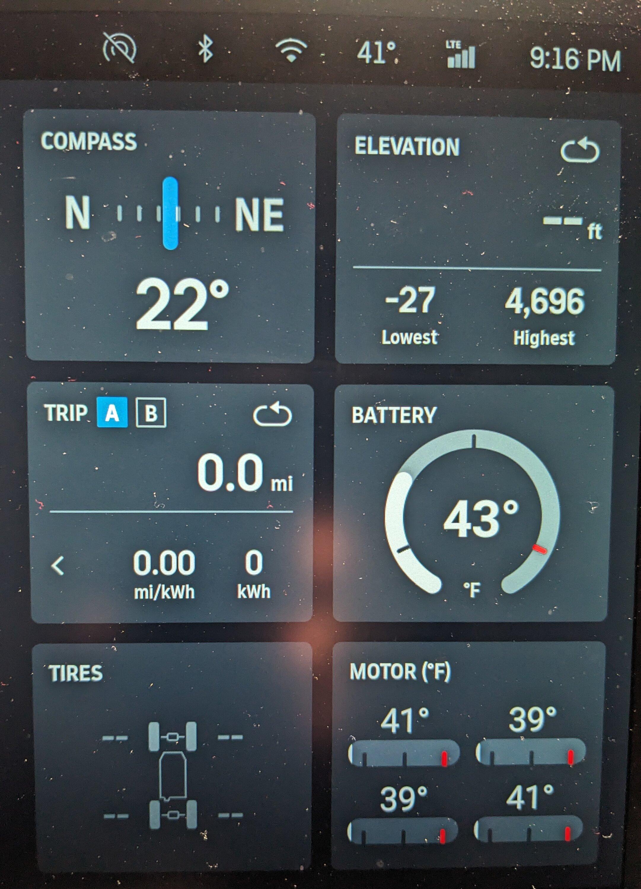

Well, shit... Here I am trying to prove @Throwdown wrong, and I just confirmed it.
Started last night at 70%/226 miles and 39°F. Set preconditon for cabin at 77°F @ 0800. Cold battery, cold motors:
Rivian R1T R1S Preconditioning confusion Screenshot_20240114-211903~2
Rivian R1T R1S Preconditioning confusion Screenshot_20240114-211715~2
Rivian R1T R1S Preconditioning confusion PXL_20240115_051635756~2

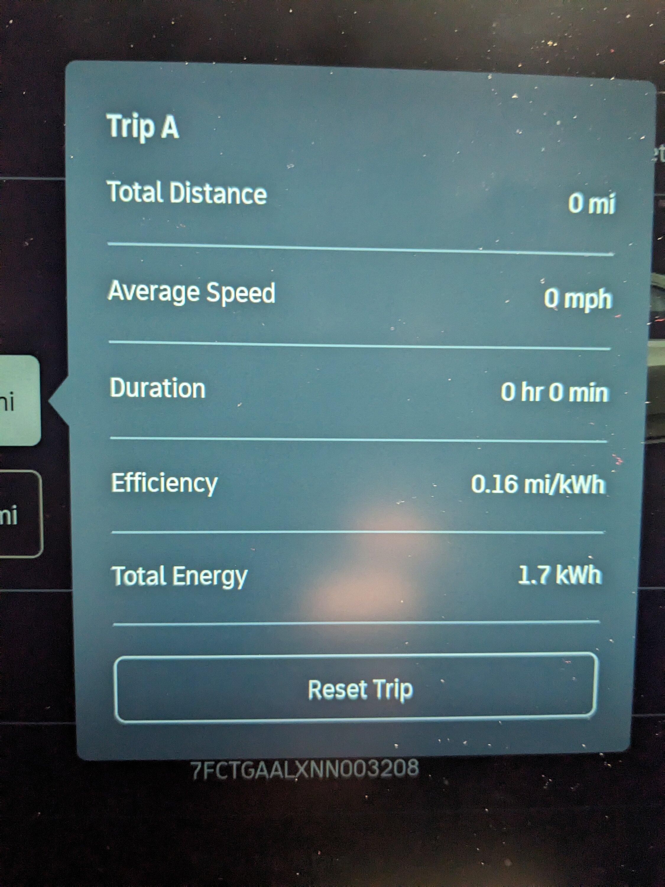

Came out of my nice cozy warm bed to snap these photos. I saw 71%/230 miles at about 0705:
Rivian R1T R1S Preconditioning confusion Screenshot_20240115-080241~2
Rivian R1T R1S Preconditioning confusion Screenshot_20240115-080233~2
Rivian R1T R1S Preconditioning confusion PXL_20240115_160148795.MP~2
Rivian R1T R1S Preconditioning confusion PXL_20240115_160207851
It used 1.7kWh to warm cabin up to 61°F, negligible motor and battery temp change, but they did go up!
I don't think I'll be driving today, so I'll test again in the AM. This time I'll do MAX heat, only floor vents on.
What you are seeing here is 100% expected behavior. If the pack is between 40 and 50°, it will not normally waste energy to try to get it warmer unless the vehicle is headed for DCFC.
Yes, there are people that feel the battery should be warmer, but most of us in the business, to include Rivian, disagree.
Ah I see, so I need to get the truck colder than 40°F. Check! I'll move it outside after breakfast and run the test again tomorrow if it gets below 40°F.
