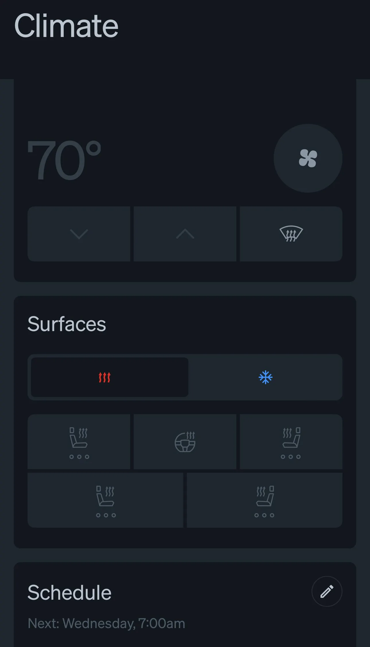

Only thing I wish they would have done differently is make the temperature set-point auto instead of heat or cold. There are times when I might need heat and other days when it should cool. Small annoyance.
Unless I misunderstand your point, it is autoset, set at the temperature you want, and it will either heat or cold to get there.
It does not. I thought the same, and it did not work today because I had the snow flake selected at 70 degrees.
As I suspected, I misunderstood your meaning... you were referring to the ap.... gotcha.
I thought the "snowflake" and "three red wiggly up-arrow" buttons only impacted whether you wanted to ventilate or heat the seats, not whether you wanted heat vs. A/C in the cabin.
