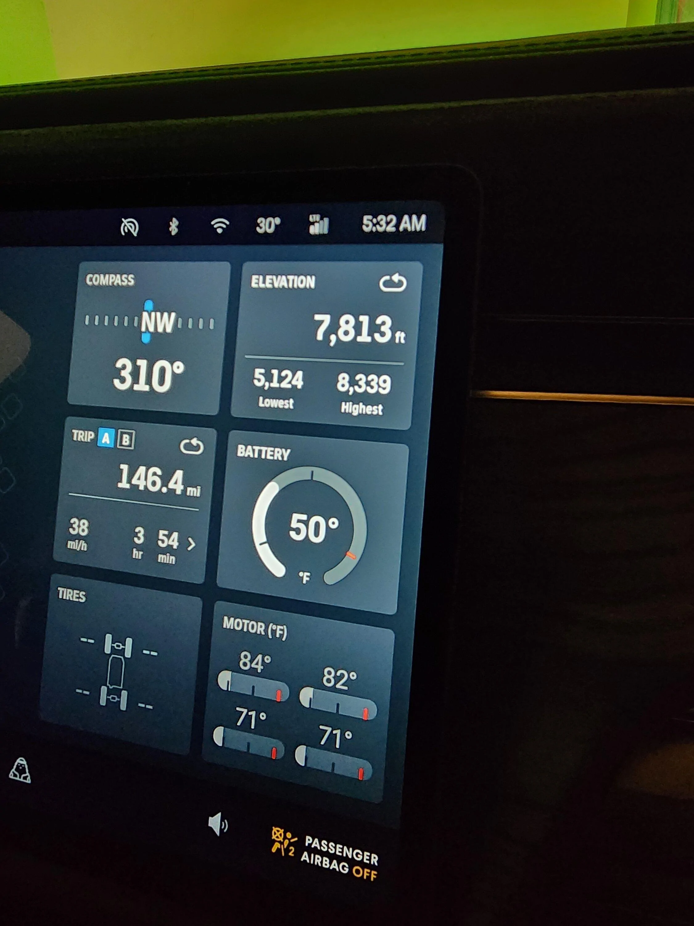

Rivian R1T R1S Preconditioning confusion 20240115_053258
This is a pic in my garage as im about to leave for work, departure battery and cabin precondtioning set yet my battery is only 50F, which means as I drive since it's so cold outside the battery temp is going to drop and have to use energy to re-heat itself defeating the purpose of their new update. So once again I'm showing that, in rivians words (battery precondtioning for colder climates, straight out of the update text)as per their latest update the system needs work. The haters of these responses can be as mad as they want or think they know more than they do, but 50F is not warm enough, and no different than at any point prior to this latest update. If they want to give an option to help cold weather efficiency then the battery temp should be selectable like the interior temp is

You’re changing your story once again.
Nope, I don't consider in the fifties battery Preconditioning to combat cold weather efficiency.. As I've stated multiple times after this past update. My battery is no warmer using the preconditioning function for departure than it has ever been. So like I originally said I call b s on It. I could be totally wrong But until they give defined temperatures for battery preconditioning I just don't know I just personally don't consider that to be warm enough.

Correct. Preheating the vehicle also triggers battery conditioning; if the vehicle deems it necessary.
In my observations, it does not trigger battery heating if the battery is over 50° Fahrenheit. This may be where the confusion is coming in, as the vehicle is not going to waste energy heating the battery if it is at least above that base level.
Actually, before the update during cold weather I ALWAYS manually turned on my seat heater and steering wheel heater about 15 mins before I left for work while plugged in, even when the climate control reported 50F-60F and it ALWAYS has heated the battery up to 70F-80F.
Same now for using the schedule to pre-heat it in the am and now in the pm before I leave work where as previously when the outside temp was < 40F at work, the battery pack never got > 62F even when I turned up the climate control to 76F on my hour ride home.

Call BS all you like, but it does work. Even before 2023.50 came out on 2023.46 I went out to the truck while it was preconditioning and the motors were all in the 200F realm and the battery had been warmed from its cold-soaked state up into the mid-40F realm. The schedule does the exact same thing, you just don't have to turn it on manually.
100% confirmed...had a schedule setup for 7am. It's been below 0F for several days now and my garage is uninsulated. Battery would've been probably in the 20-25F realm and I didn't drive for a few days, so it was cold-soaked. When I got in this morning with the scheduled preconditioning the battery was at 51F and no snowflake on the dash. Exactly what Rivian said to expect.
Before this feature existed my battery wouldn't be anywhere near 50F on departure, even if I manually set my charging schedule to try and complete a charge right before I left. Reason...I only do about 30 miles per day and only charge at 24A. There literally no way charging alone would warm my battery enough.
