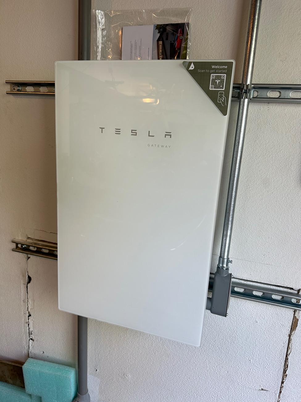

I’ll admit I didn’t read this entire thread, but I just had my V2H PowerShare installed by a Tesla certified installer for my Cybertruck and I don’t have a powerwall anywhere in my setup. They would have the smallest of batteries in the gateway *if* there really was a battery in the middle.
I’m here because I would love for the Rivian to ultimately work with my new PowerShare setup.

I’ll admit I didn’t read this entire thread, but I just had my V2H PowerShare installed by Tesla for my Cybertruck and I don’t have a powerwall anywhere in my setup. They would have the smallest of batteries in the gateway *it* there really was a battery in the middle.
Do you mind sharing the quote you have for that work? Probably help a lot of people get an idea of the cost for a VtoH setup.
MilliM
Jul 14, 2019
133
151
OC
R1S, Polestar 2
In SoCal and my job was about $5,300 less the $4k Foundation Series/CyberBeast credit, so about $1,200 out of pocket. Already had a 400amp panel, space for the new subpanel/gateway, and my panel was close to the garage, so minimal wiring from a distance perspective (just a small run of conduit inside my garage).
Thank you, is that the same gateway they use for the Powerwall?

I don’t think so but honestly don’t know. AFAIK it’s new hardware, but maybe it’ll replace the former Powerwall gateways going forward. Inside it has 8 circuits, so it’s not a whole house backup, just 8 circuits. Fortunately that covered most of what I wanted/needed. No AC or pool equipment, but I did get both of my whole house fans and most of the important living areas.
Thanks, that is what I did with my Powerwall. I’m hoping to get the VtoH to tie into the same gateway if possible.
That's very interesting - that wasn't what I understood from documentation the on the Tesla site where it talked about all you needed was the UWC and a Powerwall. I guess I have to go back and read the updated documentation.

I seem to recall that with a new generation charger they were going to try to enable V2H for (certain?) existing powerwall/gateways, but last I read somewhere that wasn’t working.
