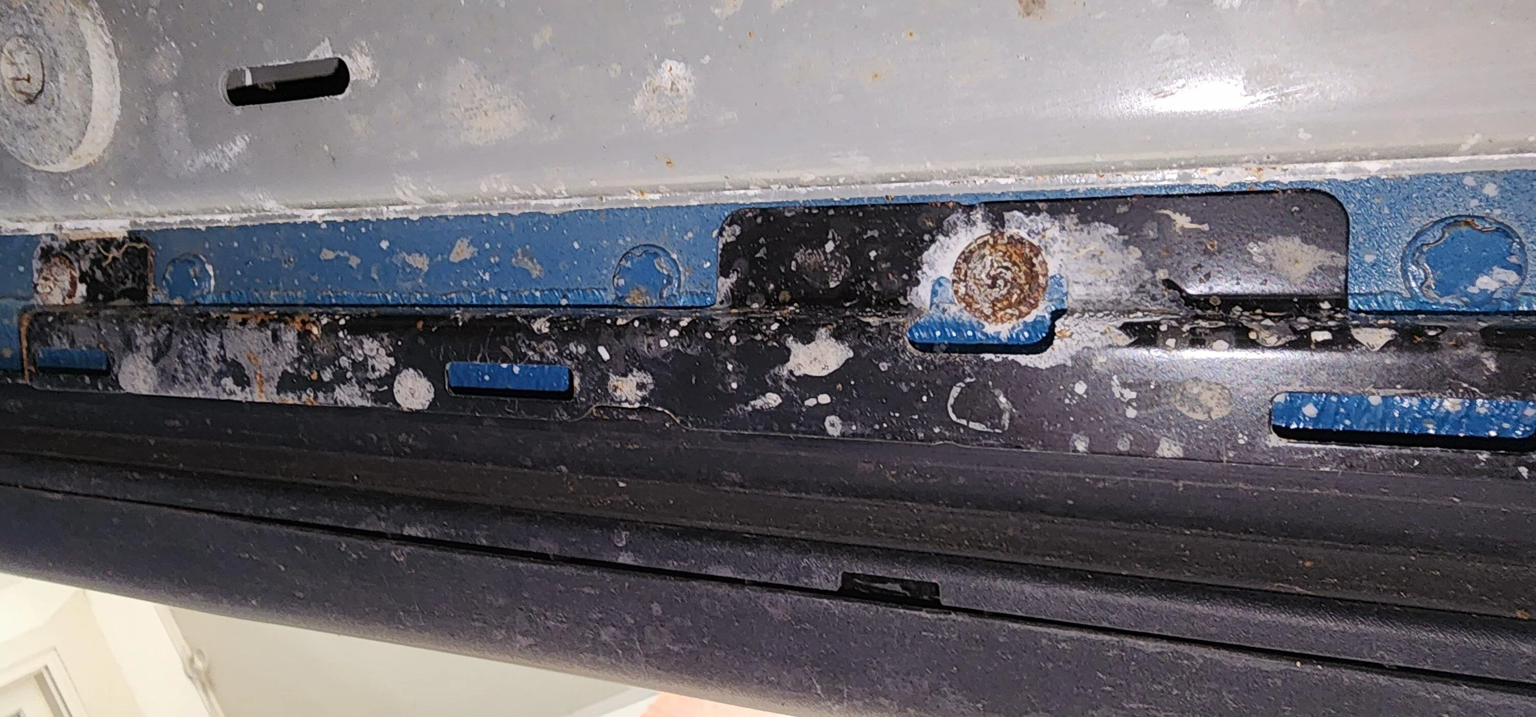

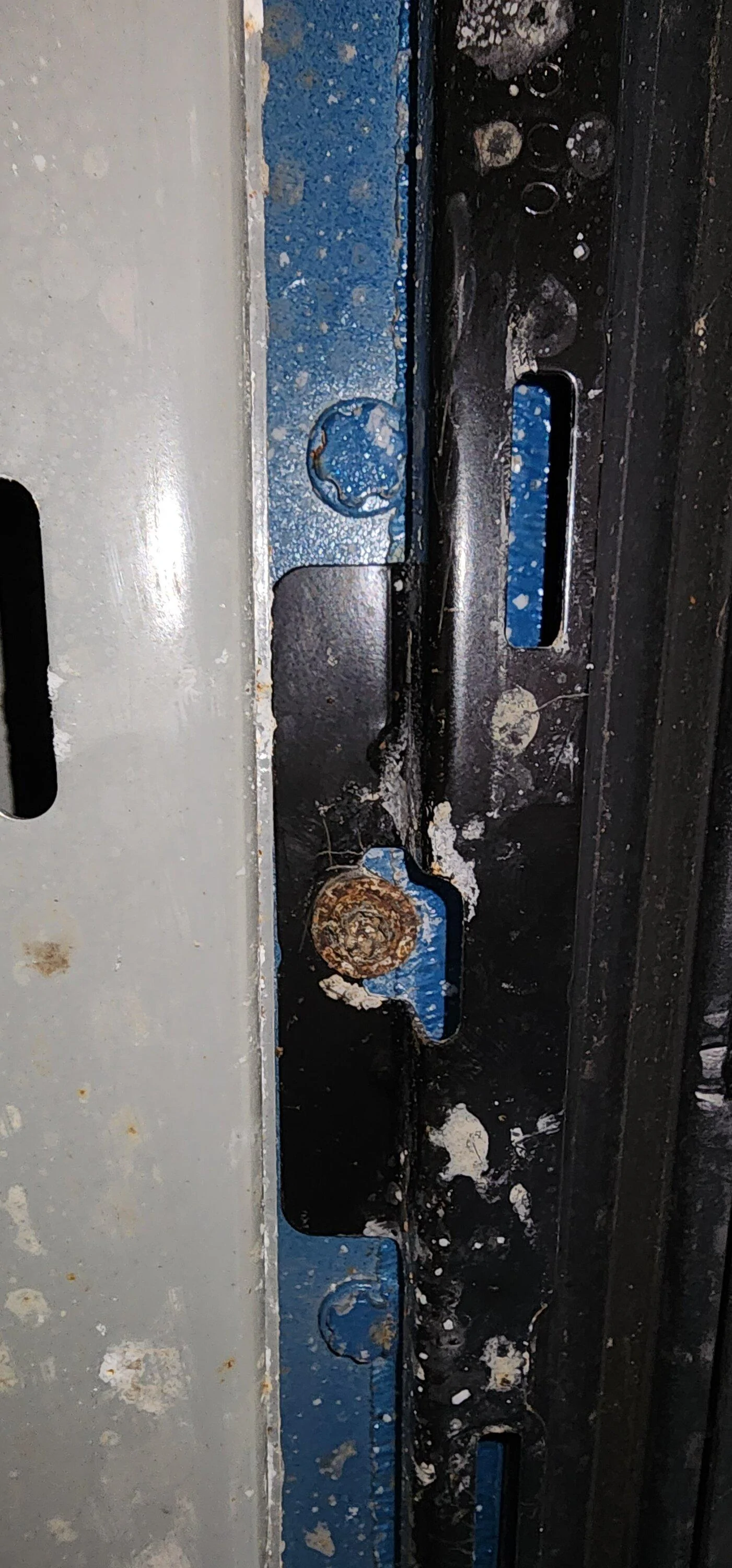

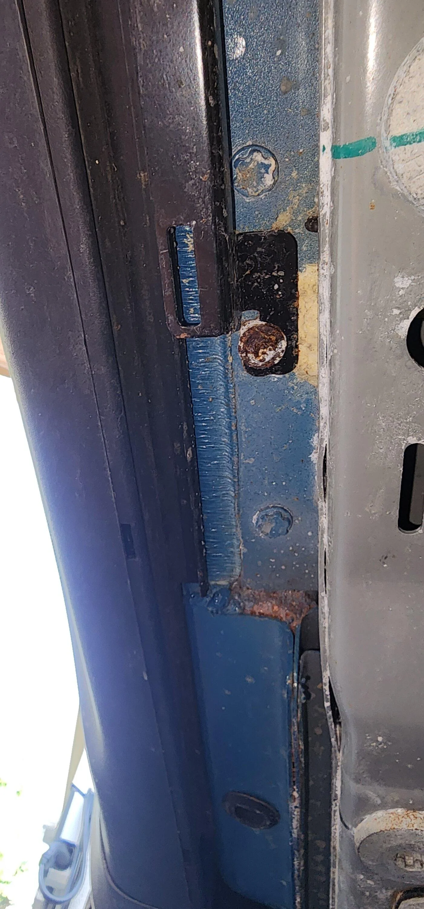

Hi all, longtime reader of this forum and have learned a ton just lurking, but have encountered an issue I'd appreciate thoughts on. Finally received my weistec rock sliders today (full thoughts on those to come soon, I hope) and proceeded to install. Step 1, remove the plastic shields on both underside. Easy enough but what is all this crud packed in here? Texas boy does not recognize road salt...
Currently stuck on step 2, removing the rails the plastic shields clip in to, because of a rusty screw that spins but won't back out (others were rusty but came out reasonably easy). I'll figure that out tomorrow, but am not happy to see rusty components under my new vehicle. I get the vehicle came from up north but how did a new one have such an accumulation? and is the rust just a sucks-for-me thing? Or an issue to be raised with rivian? Is there even anything corrective to do? Appreciate any opinions.

Hmm would be interesting to see photos if you can. How old is truck?

Is it just surface rust or corrosion?

Yes
Disconcerting for sure…. Something no one would think to look for

Concerning and notable, there is definitely some corrosion not only on the fasteners, but also on the metal where it laps in some areas, trapping moisture or crud.
Typically should not see that on a relatively new vehicle. I would suggest that vehicles that are driven in areas subject to snow/salt/mud etc, do need to have supplemental protection in those areas. There are a few product options. Coatings, rust encapsulating paint, rust protecting paint, etc.
There is something wrong with the grade of metal used for those fasteners/screw/bolts. They need to be plated or have a higher nickel content, or be stainless. I cannot see being able to remove them intact, after a couple of years.

You said Feb delivery date but what build date on the door sticker?

When I installed my sliders, I had noticeable rust already as well. My truck is over a year old and has been through a winter already, but I was still surprised to see it this soon. One of the frame rail bolts I removed let rusty water out when removed from the hole, so water was pooled up in the frame somewhere.

Hopefully this doesn't mean we start seeing premature frame failures on these.
