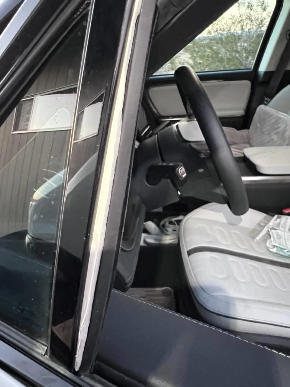

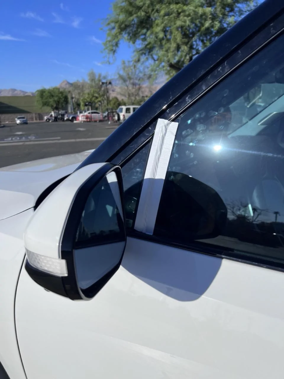

Here's how I mostly fixed mine after service center replaced the seal(s) around the driver's triangle window. Seal replacement only marginally reduced the wind noise. The tech pointed to the location before repair so when I got the truck back and it still happened, I placed a piece of tape over the area and drove it above 70 through a notoriously windy area.

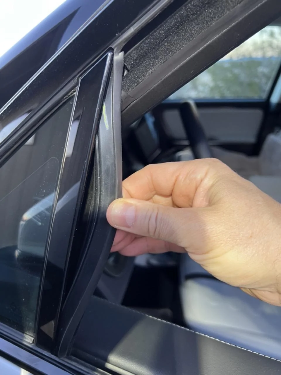

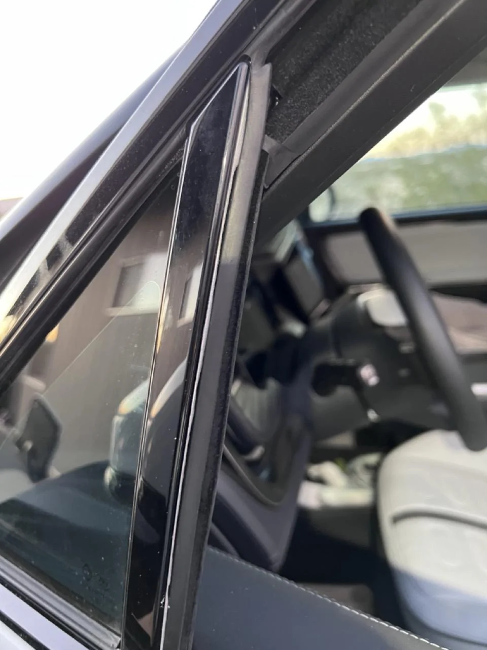

Take a look how how well the seal presses against your window. If it's weak, you'll get air ingress:

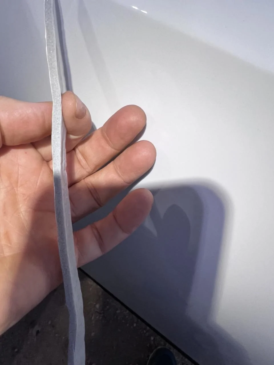

Mine still wasn't good and thought about how I could get it to press or seal more against the glass, so I bought some weather stripping from HD. One side is adhesive so I left the backing on it. Backing also provides rigidity to the foam which is needed here:

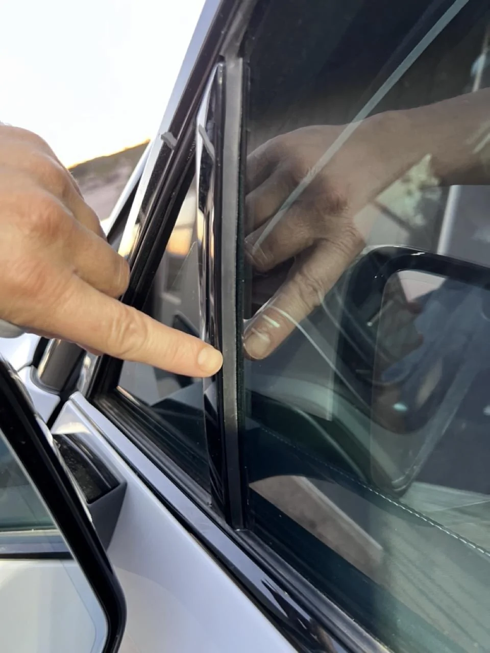

Cut a piece to length and pull out the seal:
The gaol is to insert the foam into that 3/8" wide channel in the seal. It won't go smoothly but with the assistance of a flat, non-marring tool, you should be able to get it in there. Took me several tries.

Keep pushing inwards and it disappears. It has worked pretty well for me. I was thinking of using 2 pieces of this foam, sandwiched with the backing in the middle since wind will still get through when it's particularly windy outside but it is 90% improved for me.
I did all sorts of door seals, roof and windshield lines, and what finally solved it was electrical tape on all the triangle window seals. I pulled them off one at a time and found it was THIS location with the noise. But I tried this, and no avail. I'm going back to taping just this seal and see what happens.
