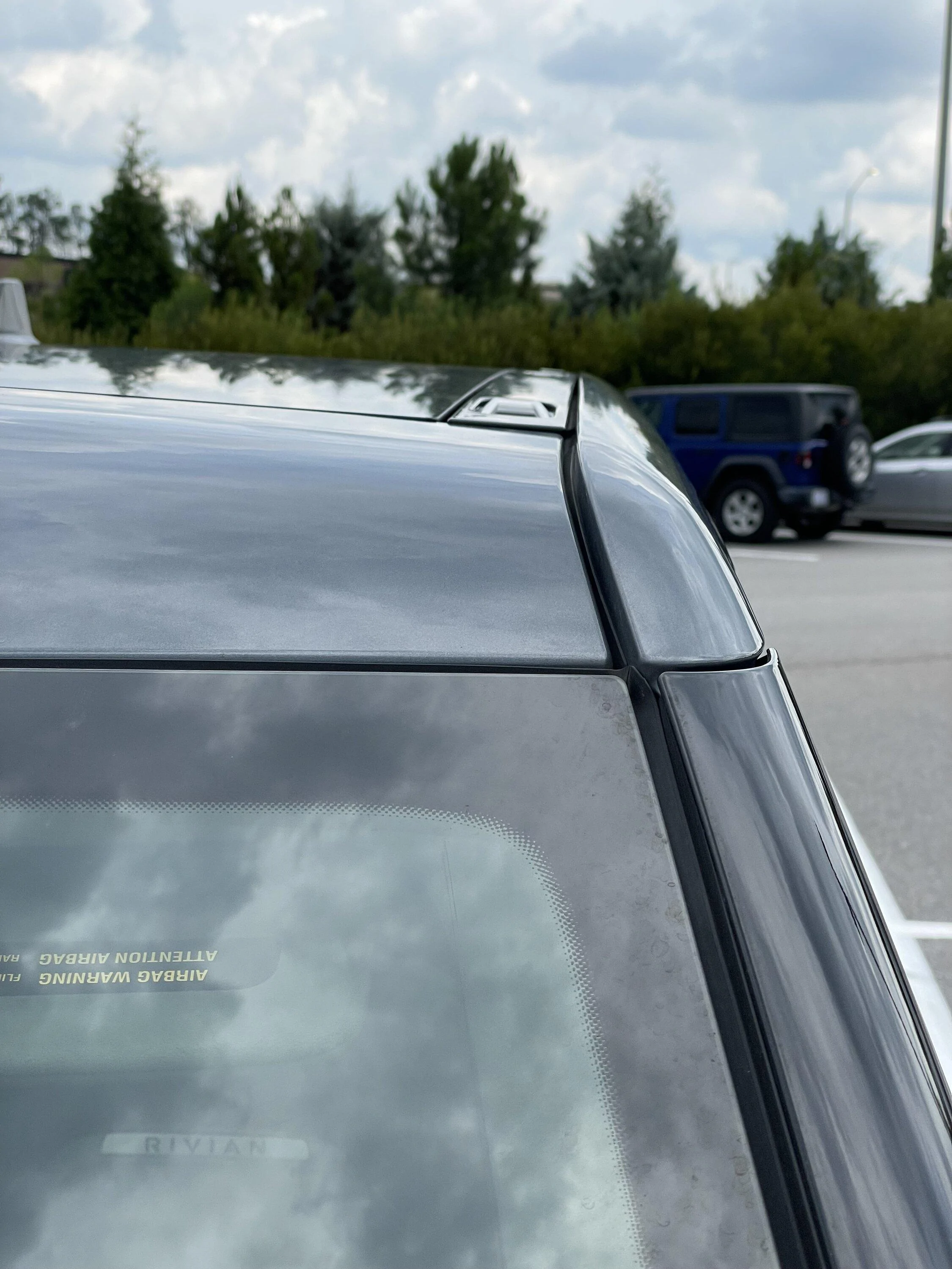

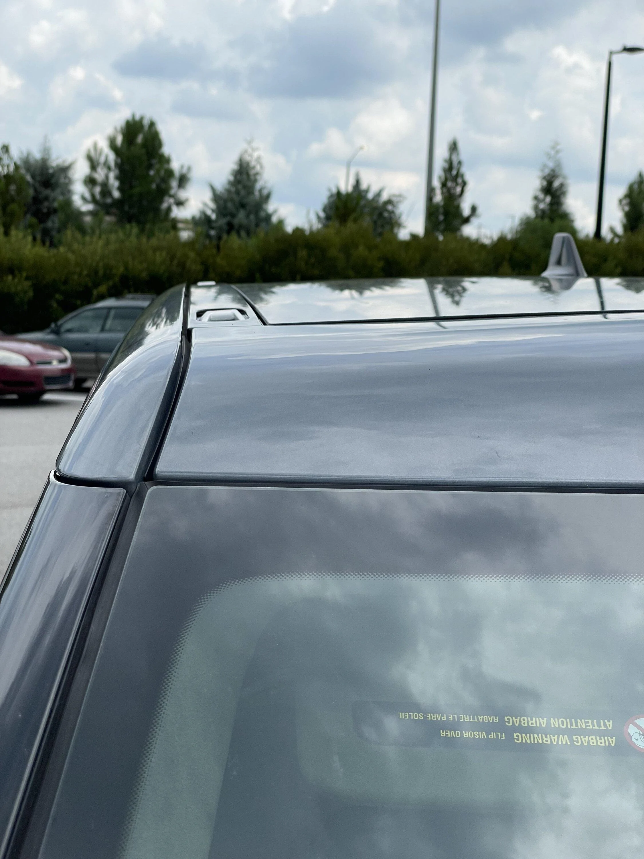

Sorry to ask. Did your fascia gap resemble something like this? Attached photo.
My earlier build R1T had noise from where the glass roof meets the fascia. On the driver's side front corner, the glass roof was a bit too high. On the passenger side, the fascia was a too high. The Denver RSC found it and had it corrected in less than a day. Once they pointed it out it was pretty obvious to see the cause.
Good luck.
