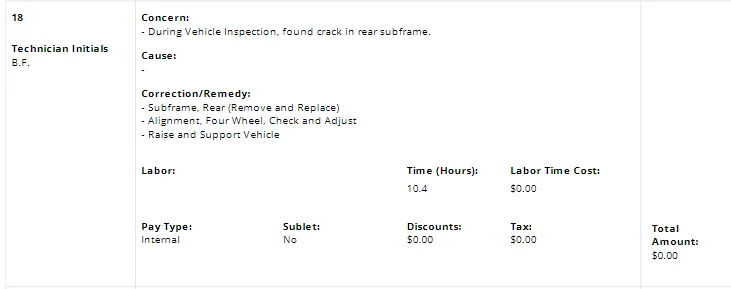

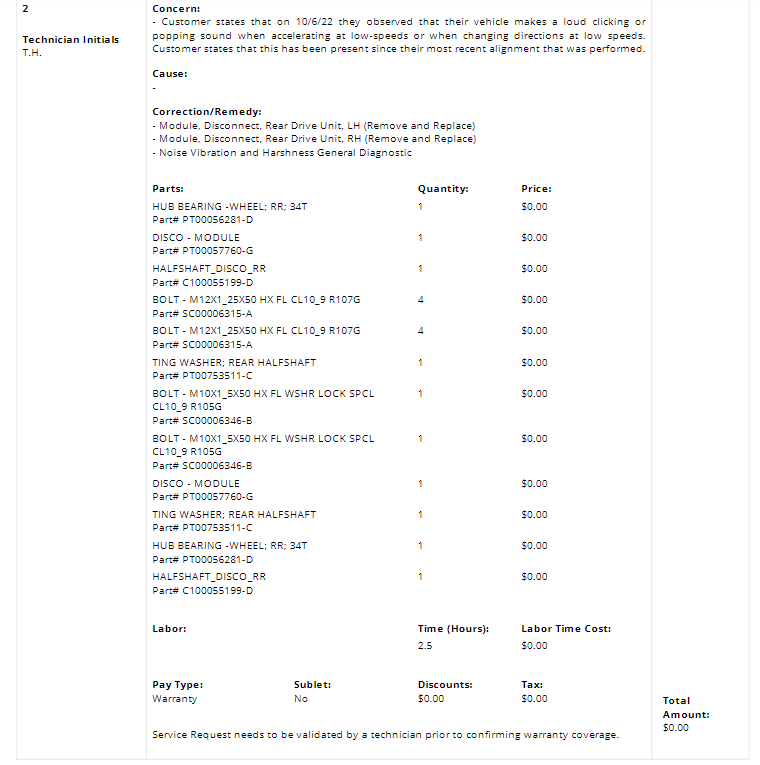

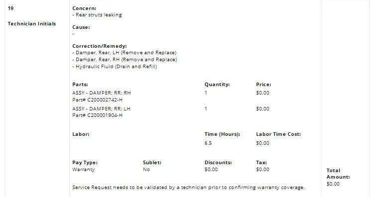

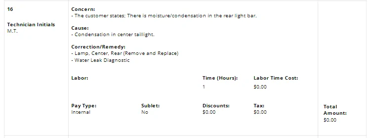

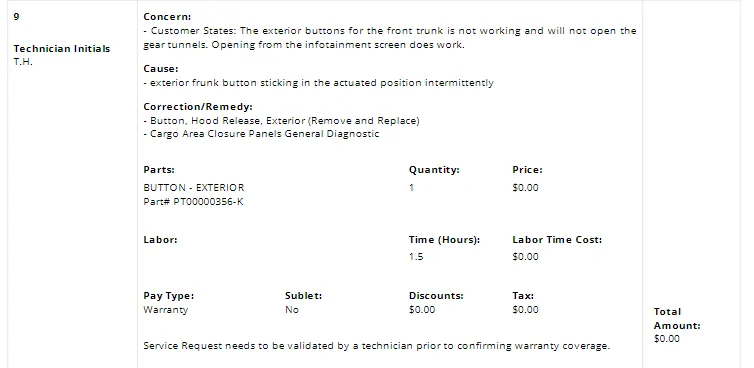

For reference. Some of the work items. Skipping a bunch of inspection and calibration items.
To their credit, they're going after it all. I've had many dealer experiences where I bring it in fully willing to pay for the work I need done, and they still miss half the list of to do's and whatever they did do, was surface level.
That's wild they're replacing the rear axle disconnects too.

My truck had the subframe replaced as well. I took it in for a cracked windshield and mentioned a noise at break and acceleration- they looked into that and also my steering wheel would make a noise when turning it. They called me and said they needed to replace the subframe. Took them about 3 days once they had the part.

I have the creaking noises in my truck when turning at low speed etc When I took it in I did a drive with a tech. He mentioned that it could be the subframe needing to be replaced. To my suprise they called later that day and said my truck was ready and it was only the half shafts that needed work.
As you can guess, as soon as I drove it home I realized the noises were still there. So I expect that I'll have to take it back and have this repair done soon.

I have my truck in Tualatin service center (Portland) for what I thought was routine issues, I had been putting a lot of these issues off because long wait times at Bellevue and convenience of taking my truck 3 hours to service.
List of issues:
- Recall
- Driver Seat Calibration
- Wheel vibration at 70mph
- The usual low speed tick/tock
- Occasional non-functioning exterior buttons
and a handful of other checks and issues that Rivian added on.
The first surprise came when they claimed that the wheel vibration was due to my tires being bad. I talked to the service manager (John) and explained to him they it has been doing this since my Alignment by the Bellevue Service center last summer (~13k miles ago) and that I had replaced the two front tires shortly after (~12k miles ago) and it has been doing it all the while. So we'll see. Told them no way I was buying another set of the Pirelli's especially if they are telling me I wore through 7 of them in 28k miles. I asked them if I brought in my extra set of 21's if they would calibrate my truck to the those tires, so tbd on that.
Regarding the tick/tock it sounds like they are replacing the rear drive shafts and the wheel bearings, so glad they are doing something there.
The biggest surprise is that apparently my rear sub-frame is cracked so they have to replace that too ? so curious has anyone else had this, is it common??
Final thoughts as usual the communication hasn't been great, the loaner (Enterprise rental Ford Ecosport) sucks and looks like I won't have my truck back until mid-next week at the earliest. Hopefully they at least solve most of these issues ?
Edit: I talked to the service manager again about the crack and he said mine was the second he had seen, I asked him if he thought it was something specific I had done (ie hard offroad driving) and he said no.

Update today from the service center. Going on 2 weeks without my truck. They are working on the rear subframe and the rear drive shaft replacements. Apparently they found some corroded parts when taking everything apart also mentioned the tech put replacing the rear dampers on the work order but wasn't sure of the details when I talked to him. I was briefly seeing a $3600 charge on my work order but was assured that work would be done under warranty.
Sounds like the further they dig the more issues they are finding on my truck and looks like the 1 year anniversary of my truck's delivery will be spent on a hoist in the shop. Looks like I'll be driving the Ecosport at least until the middle of next week... we'll see.

This is crazy. I’ve been having issues with my pano glass roof. Cracked after I placed some pressure on it during a car washing on a mild temp April NorCal day. Got it covered under warranty. Fast forward 6 months to rain and I get a leak through the sun visor arm. Eventually they determine it was the replacement pano glass roof so they replace. 2 weeks later, spontaneous crack appears on the pano roof.
I get it in for service, but have a 3rd vehicle this time so I dont need a rental and their communication sucks. 9 days later they install the glass but need to inspect the motor units and find that my subframe is cracked.
Another week at least for parts and repairs and hoping they dont find more issues. Btw, I have dont ZERO off roading or adventure driving.
