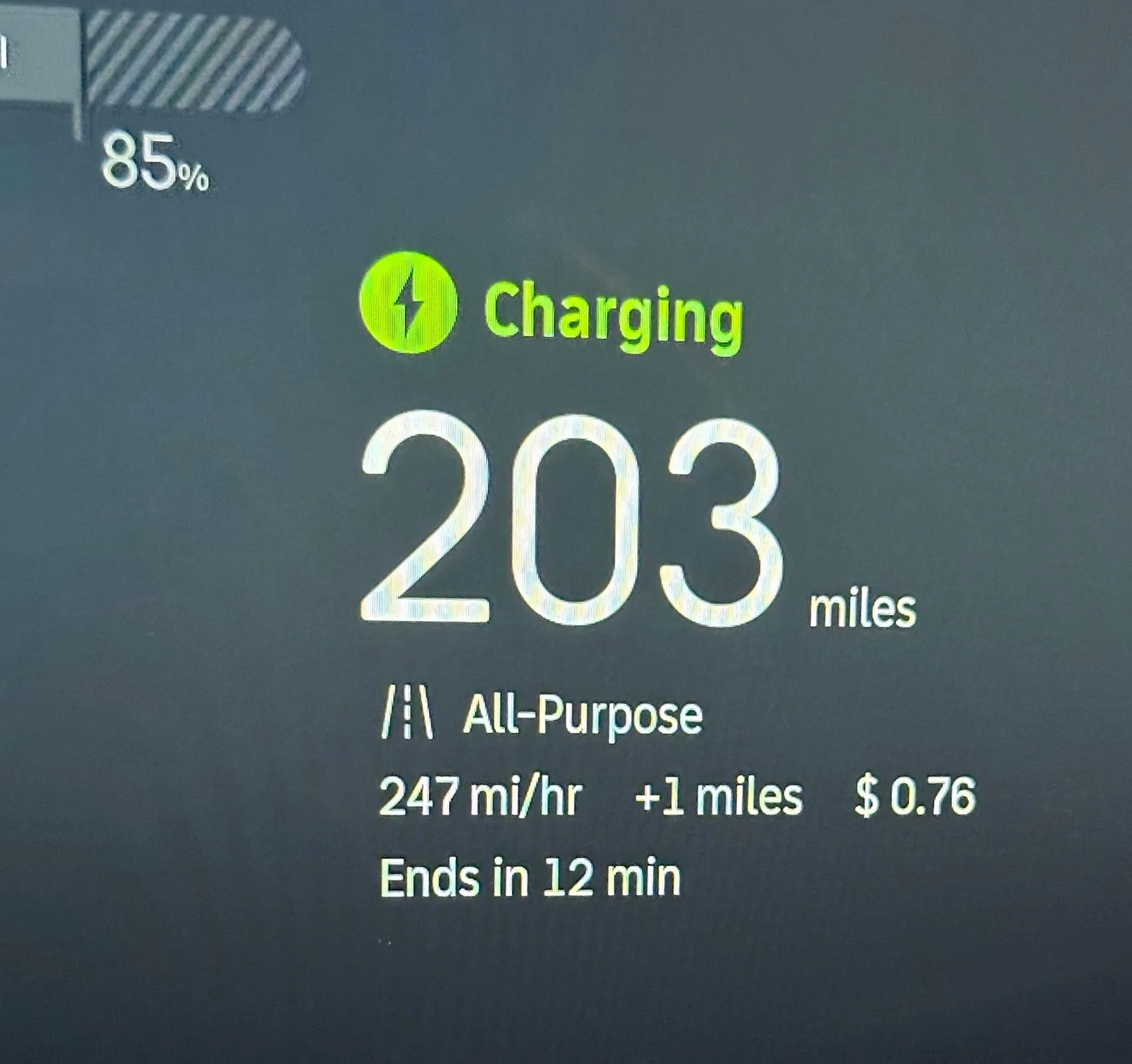

And that's it, charging started automatically after about 45 seconds or so. I had my credit card in the the Rivian app/account, so the $0.38/kWh fee charged to non-Tesla membership people was automatically charged to my credit card.
To stop the session, you have to use either your app or the vehicle touchscreen.
Even though I also own a Tesla, even if I had started the charge on my Tesla app, I still would have been charged the non-membership fee of $0.38/kWh unless I had enrolled in the monthly charging plan at $12.99/month which would have reduced pricing to $0.28/kWh.
The user interface integration is really nice. Shows a running total on the app and vehicle screens of the cost, speed, etc.

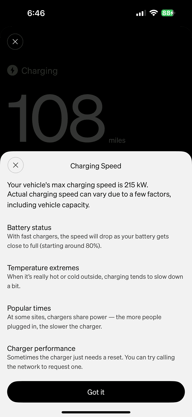

I know the RAN chargers are capable of 200kw, I'm saying I've never seen my vehicle charge anywhere close to 200kw. The most I've seen is probably 165-170kw on my vehicle, from any charger.
Here’s my R1S at a RAN charger. Plenty of juice coming in.
Rivian R1T R1S Video: Tesla supercharging pricing / cost shows on both R1 screens while charging IMG_5044
Rivian R1T R1S Video: Tesla supercharging pricing / cost shows on both R1 screens while charging IMG_5045

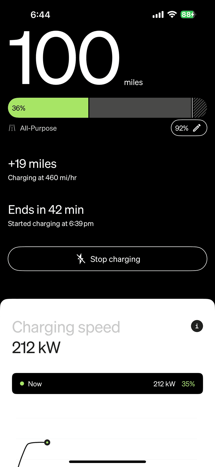

I've never seen charge rates come close to 200kw even on RAN chargers. I usually get up to around 160kw peak or so. Does the Max Pack just not hit those numbers or should I get it checked out?
I have seen 221kw multiple times on both RAN and Electrify america Battery needs to be in the 20-40% range to see these numbers.
PK
I can't tell from your signature which battery you have. Is it a Max Pack?

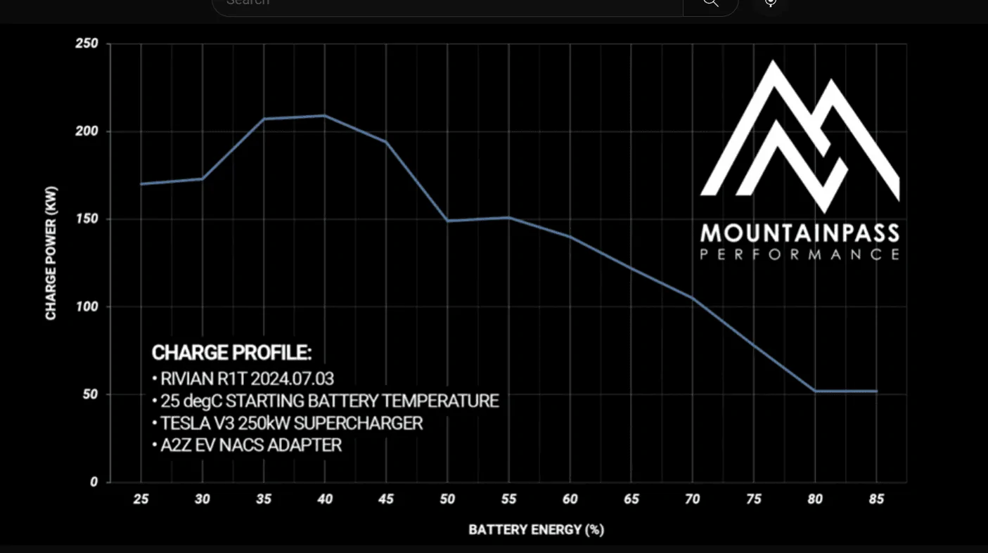

I was able to hit 213 kW using RAN with battery preconditioned.
MountainPass tested the unofficial adapter on Tesla network in this thread and were able to hit 208 kW.
I ordered one using discount code "RIV" and will use it until the official one shows up.
A2Z EV Link - NACS (Tesla® Supercharger & NACS 3RD PARTY DC CHARGERS) to CCS1 Adapter | 500A | 1000V
Unofficial A2Z DCFC NACS to CCS 500A / 1000v adapter YouTube review.
Does anyone know if Rivian has lowered the charge curve recently? I've seen 200kw right up to 50% in the past, but looks like this tapers off 200kw after 40%
