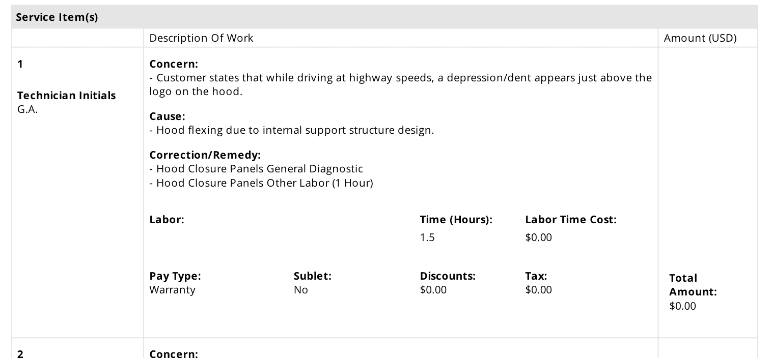

Update to mine - after the 3rd attempt - apparently they had to "remove" some adhesive and it has dramatically stopped/fixed my issue, although unclear as to where and why it wasn't done the first 2 times it was in. Notes on the service paper said "design flaw" instead of the "adhesive added" from the previous 2 times it was in.

This was what was on the service recap - first time it didn't include the "adhesive added" part.
