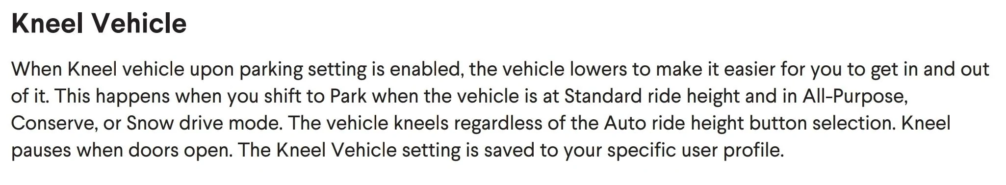

R1T Owners manual Page 28 provides some clarity for when it will kneel. Also won't kneel if compressor overheated.

Completely incorrect, unless there is a differencebetween R1T and R1S logic, which i doubt is the case. Does not have to be in auto height.
You are both right, it says nothing about auto height.

The Rivian web site says:
"Kneel mode is only available when your Rivian is in All-Purpose and Conserve with a Standard ride height"
In my vehicle on the settings page it says:
"Vehicle lowers to low ride height in All-Purpose, Conserve, and Snow for easier entry and exit"
(nothing about only working in standard height).
