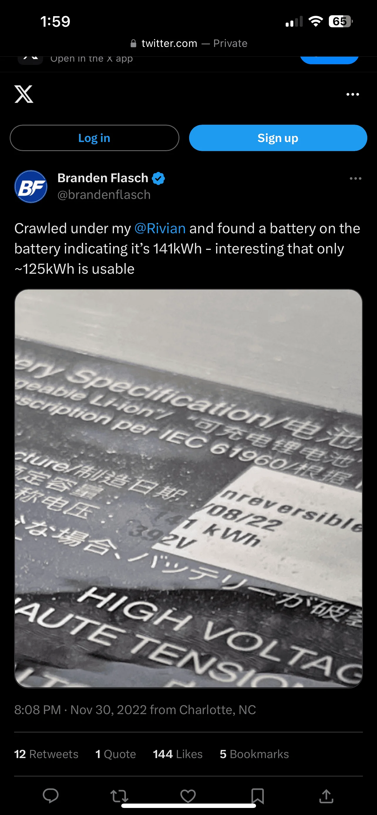

I believe our battery is 14 kWh but we only have access to 127 kWH and they’ll slowly release the buffer to account for degradation.

https://www.batterydesign.net/rivian-r1t/

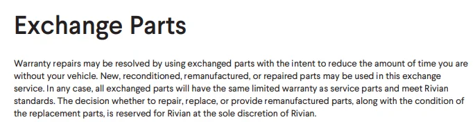

There is not a warranty concern. Charging to 100% every day is not going to void the warranty. However, the warranty specifically permits Rivian to install used parts when they perform the repair. So when you do drop below 70% and Rivian does replace your battery, all they have to do is push you back above 70%. The "replacement" might only push you back up to 75%.
