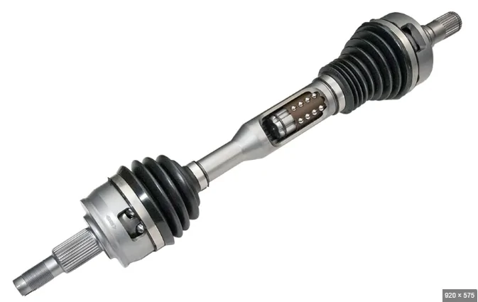

I have not had the drive unit(s) replaced, but definitely had all sorts of those issues with my old Gen1 Quad. They replaced dampers, jounce, and halfshafts. Nothing stopped the ever-worsening rattle and clatter from the front. I'm interested in how this works out for you.
My new Gen2 Tri is starting to rattle just like my Gen1 did. I only have 1300 miles on it! Ugh.
Sound for me is much worse in warmer weather.
It's the half-shafts, they have a sliding mechanism inside that allows your vertical travel. If the shaft didn't have that sliding internal design it would be silent, but your vehicle would have no lifting or lowering ability.
