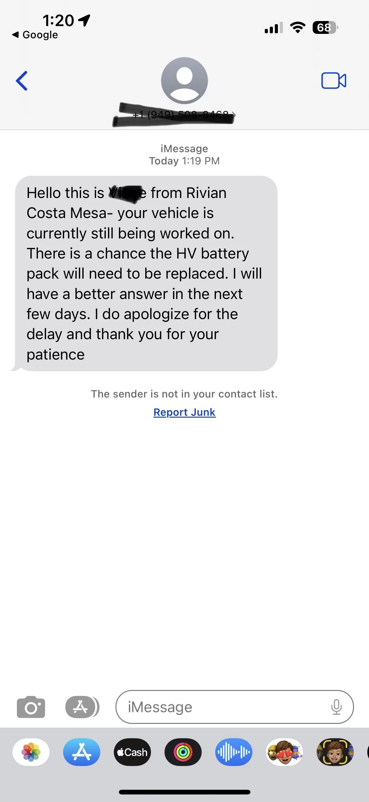

Took deliver on my R1S late June and had 800 miles on it. Range started degrading drastically around 600 miles. At 100% state ofcharge, I only got 150 miles... Dropped it off last week and received this message from the service center. Hopefully everything works out with no problems in the future *sigh*
