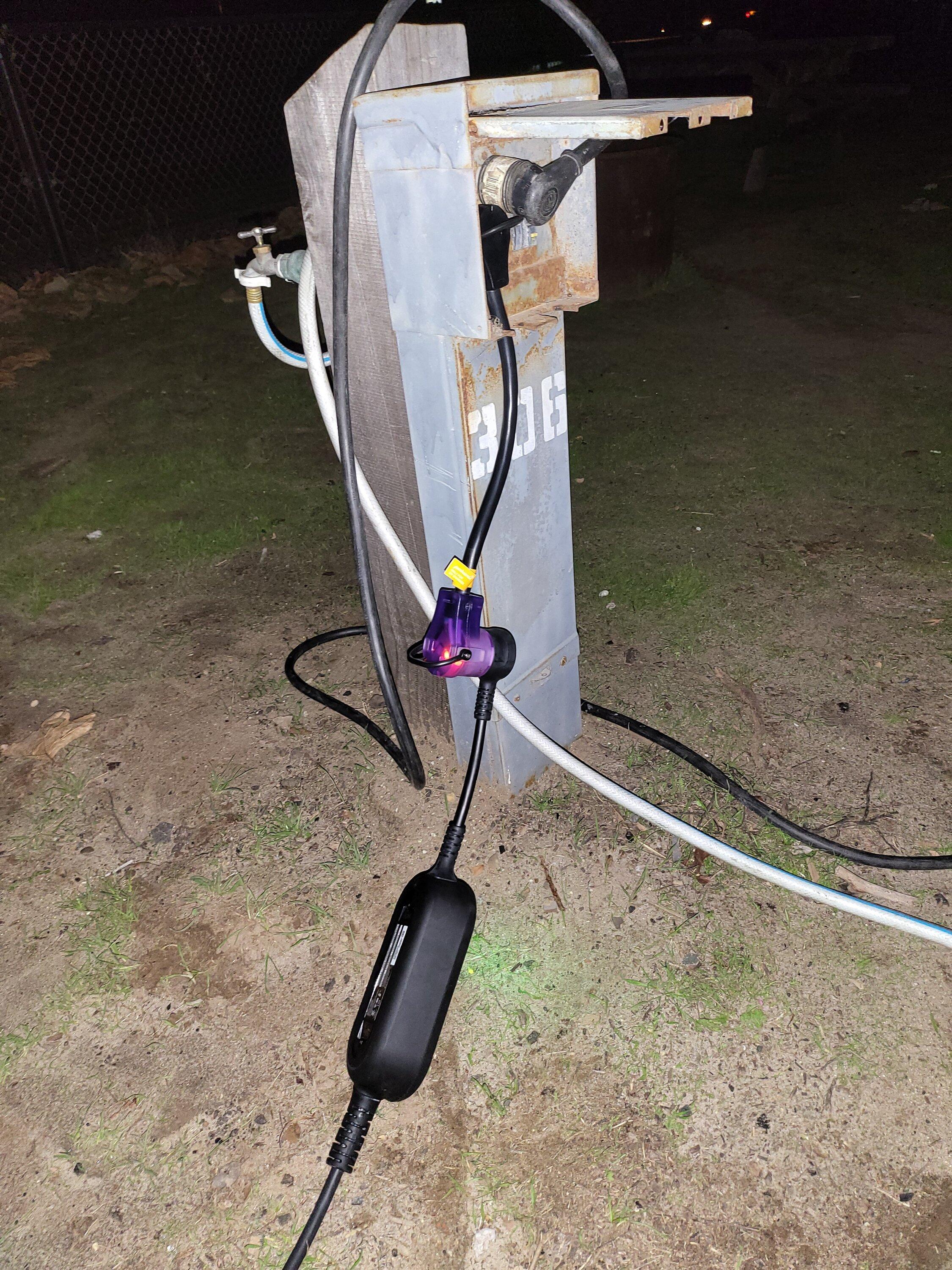

I'm not sure how buying a Tesla product helps on a ccs car but it's all adapters anyway. For 110v charging extension you will want at least a #12 wire which is 20A (25 ampacity). Uncoil to avoid inductive heating. It's hard to know what you'll encounter for plugs.
So far I've only bought a tt30ev adapter because I frequent RV parks and some don't have a 14-50.

To specifically answer your question, " buying a Tesla product" Will get you up to double the power out of that outlet when compared to the setup you have pictured. The Tesla unit will not only identify that you are using a TT30, and draw up to 24 amps out of it, but it will continually test it to make sure the wiring and outlet are healthy enough to maintain that.
The setup you have pictured is simply pulling from the TT30 as if it were a 15 amp outlet.
You are mistaken. The tt30 is going into the 14-50 on the rivian mobile charger which can draw up to 32A. The cost is for this adapter is almost nothing compared to buying a Tesla adapter that needs adapters on both ends to work on a CCS car. The bundle doesn't even come with a tt30 so after buying the bundle I'd still need to buy the one. The automatic amperage setting on the Tesla is nice but I can set it in the Rivian as well.
Ah, you are using half of the 220 on the EVSE.
Yikes.
It's no different than the 5-15 110v adapter that comes with the rivian except it allows more than 12A.
