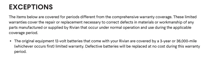

The warranty states the 12v batteries are covered for 3 yr, 36k miles....this courtesy replacement is horsesheet.

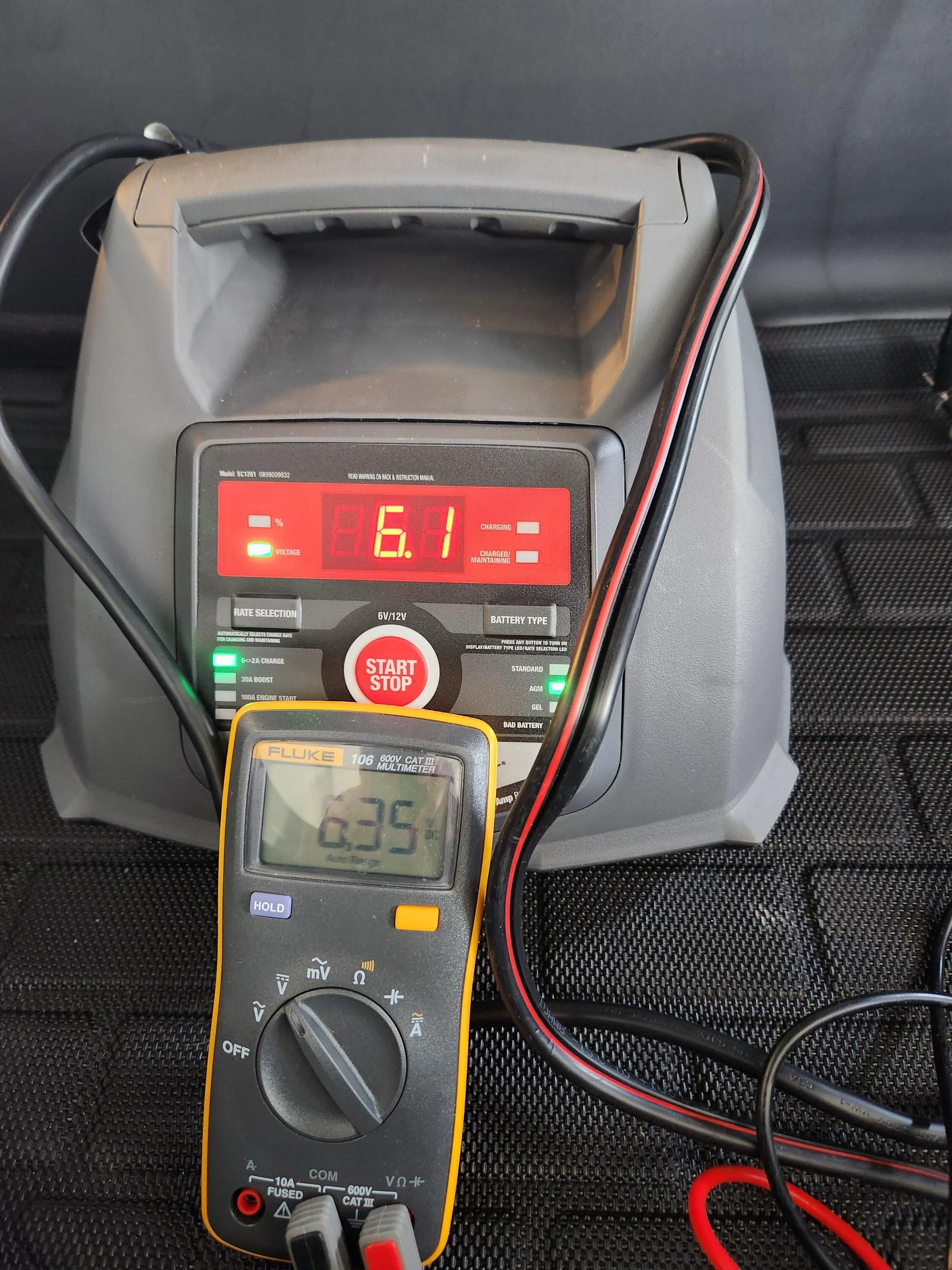

So central service asked me to plug in the truck while I await service. They said I could manually release the hood and the charge port door. Told them they were right about 1/2 of that. You can open the hood manually and release a charge plug...but you cannoot open the charge port door manually. Anyway, I thought I'd open the hood and check the batteries . They were at 6 volts (see pic). I did very briefly apply charge to see what would happen and everything woke up almost instantly. But I don't wanna f$%k with it anymore and/or f#%k something-up...I'll just let them fix it. But it appears the answer to your question is most likely...replace the battery and the truck "fires" right up.
I highly doubt the charger will be able to activate with the system voltage that low. But that's potentially something else to try during a jump.

It's a pretty nice Schumacher charger and like I said I did use the charger briefly at 30amps to see what would happen. Everything turned on instantly...screens, headlights, charge door operable. Also note that I did try to measure the voltage from the jump wires in the hitch and it couldn't measure anything. Such a weird thing going on with these batteries....GOTTA be a software thing. But it's way out of my depth.

It's a pretty nice Schmacher charger and like I said I did use the charger briefly to see what would happen. Everything turned on instantly...screens, headlights, charge door operable. Also note that I did try to measure the voltage from the jump wires in the hitch and it couldn't measure anything. Such a weird thing going on with these batteries....GOTTA be a software thing. But it's way out of my depth.
ah, yeah I meant the HV battery charger. Jump starter/charger should be able to get everything going but whether or not the DC-DC converter onboard will kick on is the important thing to happen. If it thinks there's an issue with the HV battery it might not.
