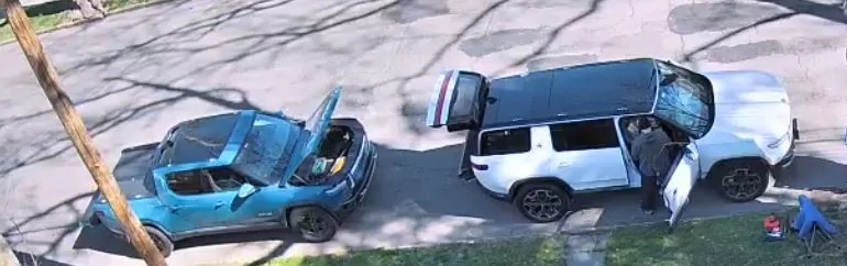

2023 R1S. Took delivery in January. Truck would stopped shifting into Drive/Reverse and the climate controls would not turn on. The following day the truck was bricked. Mobile tech coming Thursday...I expect a tow to Brooklyn to follow.

Did you get the latest update yet? If not, then that's just crappy timing because the update is supposed to fix this.
2023.6.2 is the update I currently have. I believe it came thru and installed earlier this month.

2023.10.01 is the latest update so that sucks that you just missed it before your truck got bricked.
Yeah.... Rivian Mobile tech is wrapping up. He said the same thing. Took 2hrs but they just finished and truck seems good. Im lucky...I did a 550mile round trip over 13hrs the night before to pickup some used Tesla MSP 21in wheels...happy I didnt get stranded on that trip.
