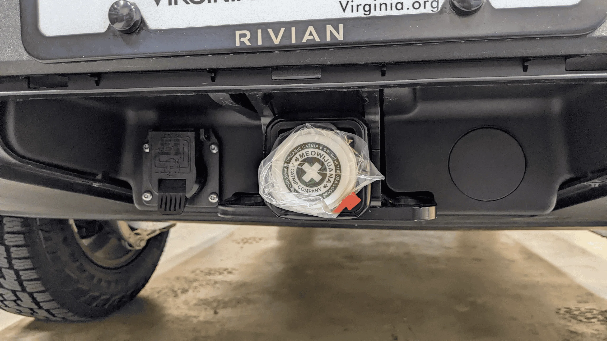

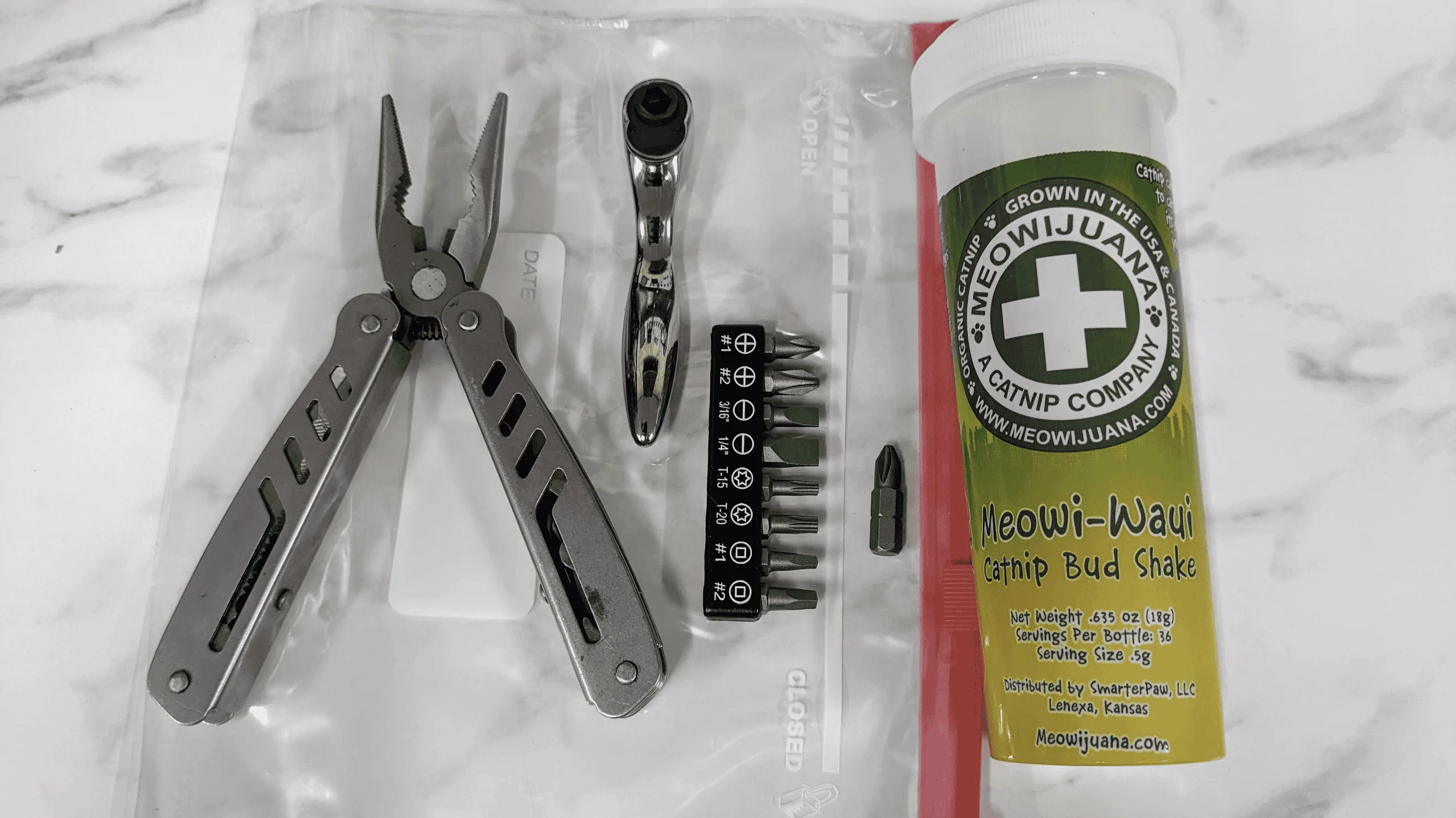

Serious? Sure. Why not? Better to have 'em and not need 'em than need 'em and not have 'em.
Rivian R1T R1S R1T 12v batteries dead 1691043046513
Rivian R1T R1S R1T 12v batteries dead 1691043074474
Been repairing my own vehicles for 30+ years. This is just new stuff to learn. Certainly not something to give up your truck over. Where's your sense of "adventure"? ?

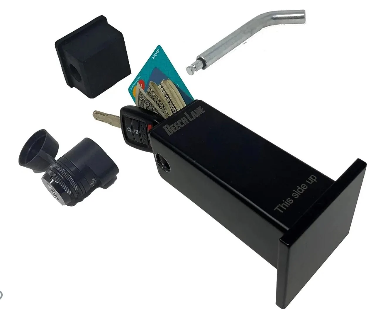

Nice setup! I've seen some hitch storage boxes too.. was thinking of getting one and slapping a couple of these in there!
