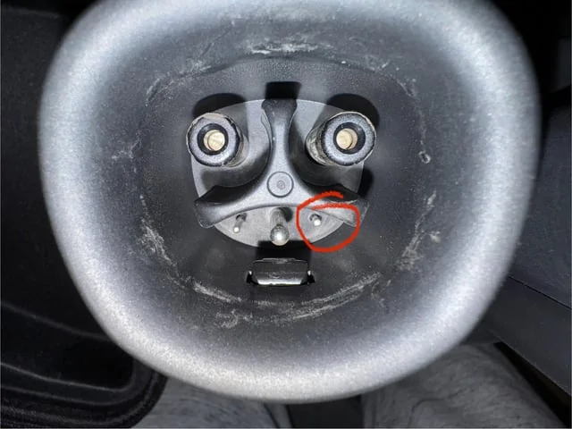

Some of the early on Typhoon Pro had a short communication pin and would not register on V4 cabinets.
Reach out to Technical Support and let them know the issue you had / share your receipt.

So, I found a reddit post talking about the short comms pin on the early runs of the A2Z charger. I looked at mine and it looks like the attached image. I'm reaching out to A2Z to see if I can get it swapped with one that has the longer pin. Until then, I'll bring both charge adapters with me.
Thanks again to everyone for helping with the troubleshooting, looks like this problem is solved.

Emailed A2ZEV and their customer service is top notch. They confirmed the pin issue and got a new one shipped out the same day. It gets here Thursday. 11/10 company.

[SOLUTION 8/12/25] They first few Typhoon Pro v2 adapters have a comms pin that is too short for the Tesla V4 Supercharger.
These types of issues are exactly why Tesla and Rivian want you to use "factory" adapters.

Thanks for this. Contacted A2Z today about mine and they're sending me a new one. Even told me not to worry about the tariff.

Is there an easy way to tell if the adapter is one of the defective ones?
The pin on the right side is shorter than the left.
That pin is the communication pin which is why the adapter doesn’t work at V4 stations
