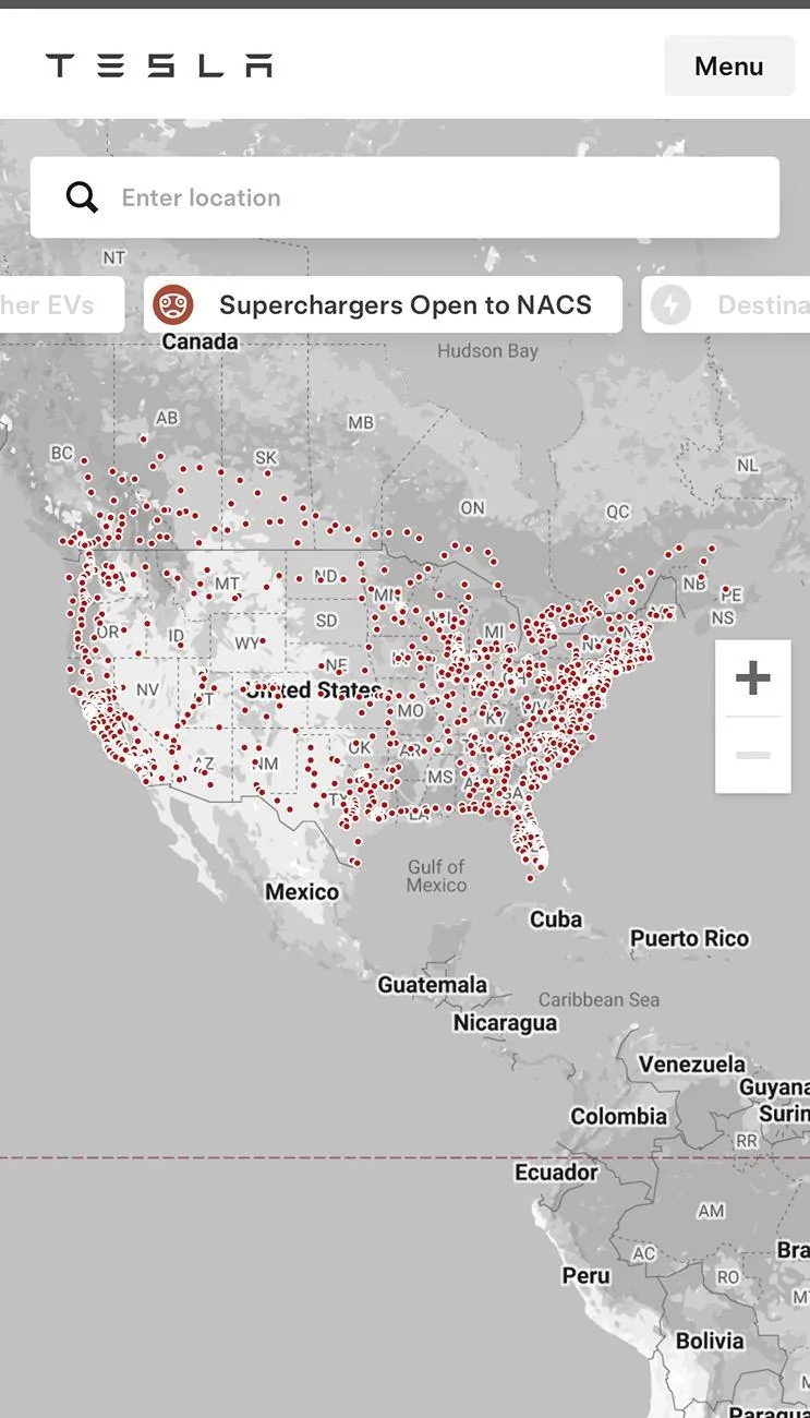

You can always double check using Tesla app or PlugShare to find out which stations are open to non-Tesla EV.
Also you can use the below Tesla Find Us link to identify which station require an adapter and which ones already have a built in Magic Dock.
Tesla Find Us Web Link

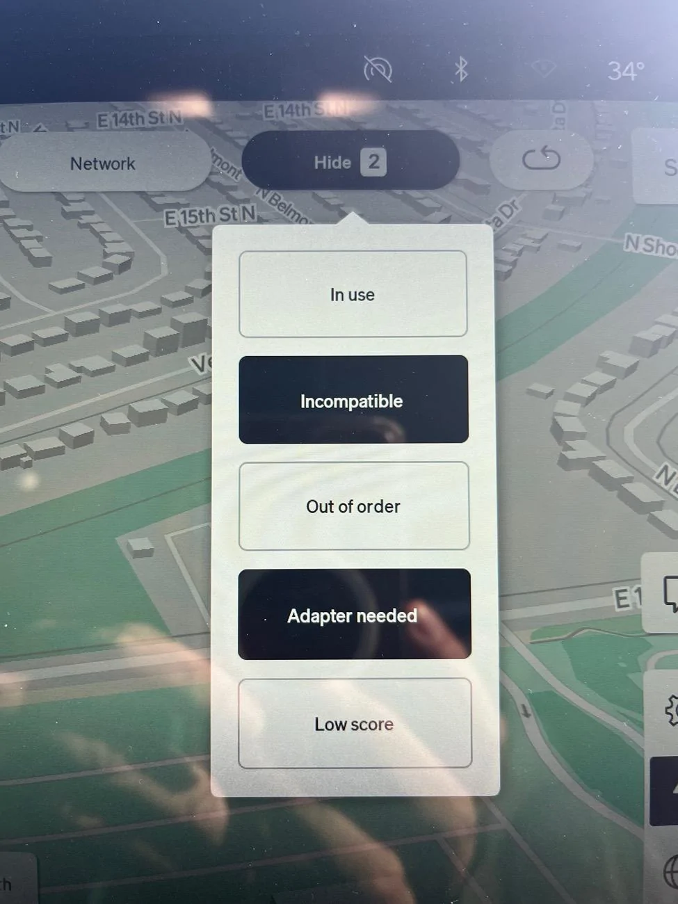

So, `Adaptor needed` filter is misleading?
DeafPug
Oct 20, 2021
573
854
Kansas
'18 Model 3, '22 R1T
Thanks.
No, the menu is labeled Hide. The charging stations that match the selected criteria are hidden from view. Selecting Adapter needed in the Hide menu will hide the (Tesla) stations that require you to supply your own NACS to CCS1 adapter.
Ah... all filters are under "HIDE" !!!

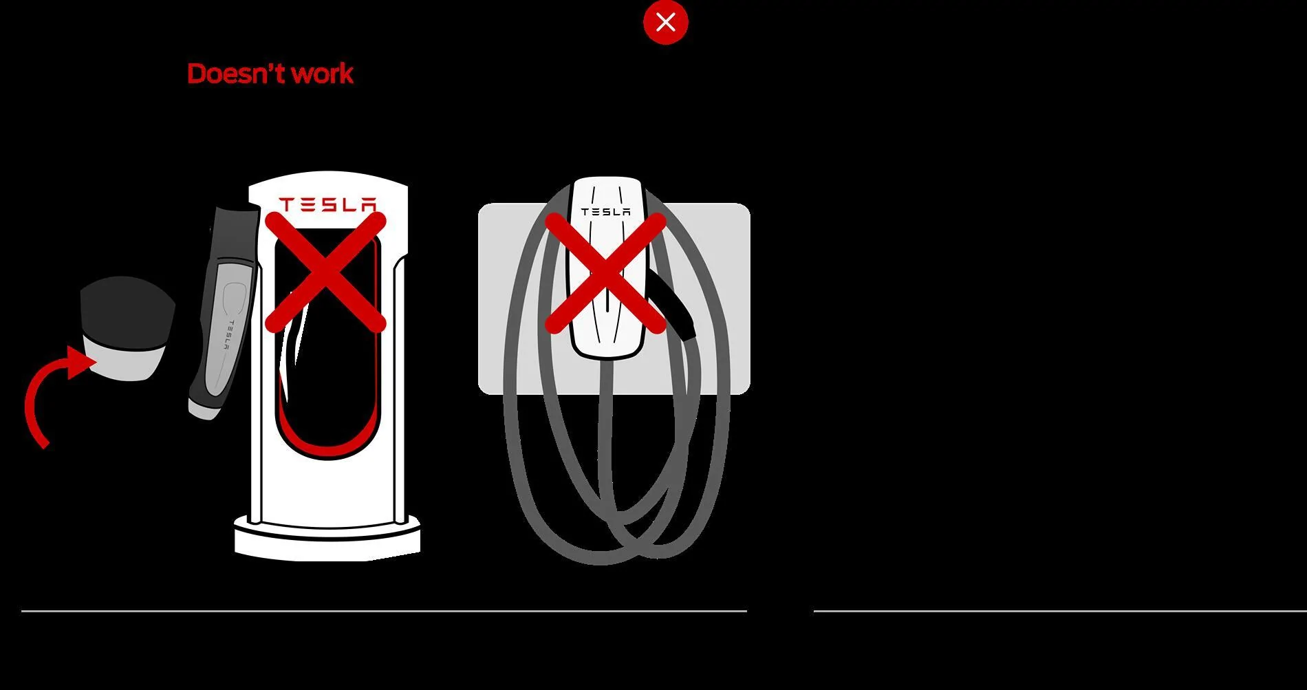

V1/2/3/4 is the version of Supercharger. You don't need to care about that if you just look in the app for "compatible." But just in case you see one and want to know at a glance:
What you want is a Supercharger stand that looks like one of these:
Rivian R1T R1S Which Tesla chargers can I go? Screenshot 2024-09-17 at 6.59.54 PM
If a V3, the "collar" on the handle will be black instead of silver. (Yes, the diagram I found is wrong.)
Here's from Ford:
Rivian R1T R1S Which Tesla chargers can I go? 1726625015103-6i
