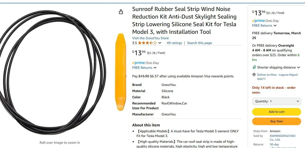

Gen. 1 R1S. I had an obnoxious rattle on the top of the dashboard. It only occured when the dash was hot from the sun and on rough roads. SS tried to fix but no luck. I noticed the rattle stopped if I pushed down on the grille where the grille and the leather dash meet. I purchased 5.00 mm black rubber hose from Amazon ( I think it is actually advertised as a fix for the Tesla sunroof wind noise). With the yellow tool that is included, I wedged the hose (patience, it is a tight fit) between the metal grille and the leather the full length of the dash. It is visibly unnoticable and worked perfectly. My guess is the grille expands and contracts with the weather just enough to rub and rattle.

Do you have pics and a link to the product you used?
Thanks! This has been driving me semi-nuts recently as well. I'll give that a shot.

Have this issue also. Pretty sure it's not because something is broken or not put together right. But a design/engineering oversight. Lake Forest CA SC did not want to dig into it back in January because it wasn't rattling for them. I think I will try this myself, instead of pulling the dash apart like other threads. I think the heat makes the dash flexible enough to bounce and bang against what is underneath (speaker mount) and that's what makes the rattle/thumping. Wedging this between the grill and dash probably reduce slack just enough to not flutter as much.
Please post pics. Thank you!

Adding that I've had this issue since ownership (late '23) and after 3 separate and unsuccessful attempts by Gaithersburg service center, I fixed it myself in a similar manner - wedged small pieces of black plastic between the dash grille and the dash soft "leather" area; about 3 of them. This worked for me for nearly all the time. However I think I'll try your method to have this buffer for the whole area. Thanks!

I had the same rattle but I fixed it adding felt tape practically using the same method, but I thought that since it has adhesive, it will hold a bit better.
Nevertheless, the rattle is gone.
