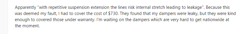

Wow David! I had no idea these lines were a risk of anything other than that annoying loud squeaking noise. Especially concerning an apparent issue if using the height adjustment features...the truck was supposed to be designed for that. But it sounds like that is putting stress on the lines over time.
I put in a service ticket, but my appointment in Seattle isn't until Nov. 5...
Thanks everyone for the insight. Those with upcoming appointments in Seattle, please keep us posted on how things go.

AKA off-roading, camp leveling, and all the other "features" they rave about? That's wild they charged you anything! Aren't you still within warranty? Is the off-roading warranty period different?
Mine goes into the Seattle SC in early September for the random service suspension issue (most likely sensor connectors as it only happens after a car wash or rainy drive like today). I'm going to mention jounce issues and see how far the eyes roll.
I am within warranty, but they probably mean repetitive as in rally mode for 45 minutes going quickly down a trail or constantly hitting the suspension without a break, not "normal" camp leveling and stuff. I did push back a little bit but since they covered the dampers (expensive bits) I thought it was a fair trade. Just like a Jeep or Bronco, there are things that will break even under normal usage that might be considered normal wear and tear unfortunately. I don't think the jounce lines should be one of them, but oh well.
You're probably fine if you're not doing anything out of the ordinary. I use my truck hard and go off-roading bi-weekly so something was gonna break at some point. It's just worth checking.

So the updated jounce lines are anticipated to fix 2 known issues:
1. Squeaking/Chirping noise on uneven roads
2. Probability of leaking/failure due to overextension of air suspension in off-road modes
Is this reasonable to expect?
Mine makes all the noise and I haven't left pavement yet. It's way too noisy to risk it. I don't think you caused it, I believe it's a defective part that was never updated for gen 1 since day one.
I wonder if the retrofit jounce line and retrofit damper are both gen2 designs being installed in noisy customer gen 1s.
My girlfriend has heard the noise and said if she didn't know any other this, she would have just drove it without any complaint. It's super noisy for an $85,000 vehicle, she's just not the type to care. That's what Rivian banked on since discovering the problem and reengineering a better design.
