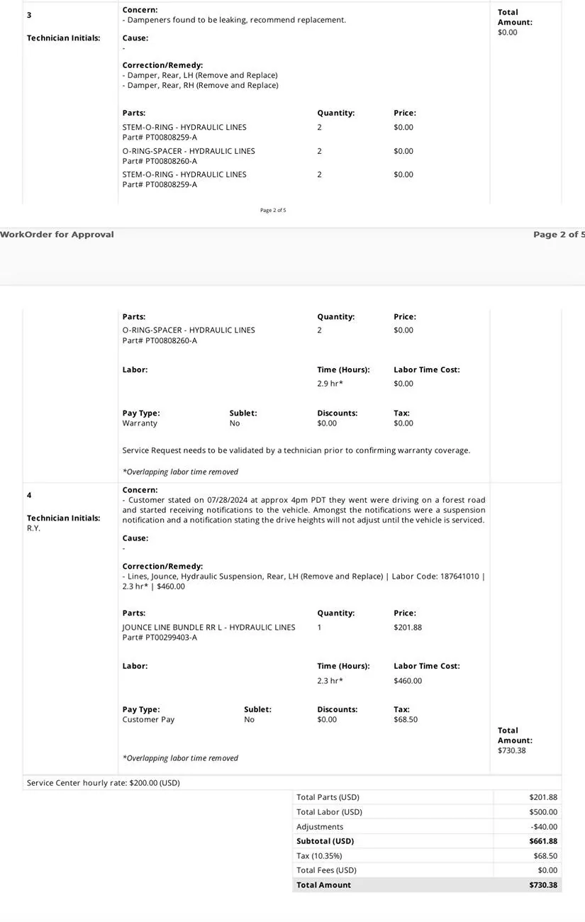

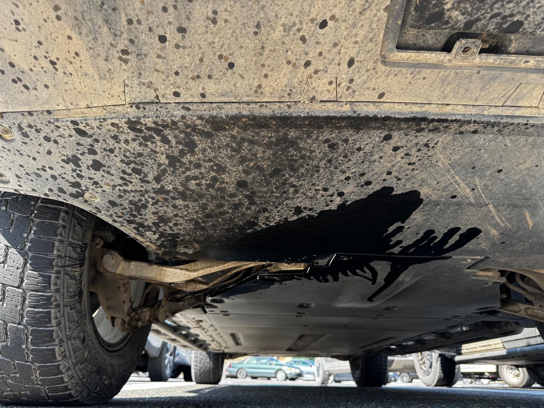

@godfodder0901 @Riviot @kyledmb @Schroederhc @ExhibHooligan @dinimobile - Hey everyone. David C. here from Emerald City Rivian Club. Love all the jounce line talk haha.
I'll chime in and say if you think they're squeaky or having any issues, submit a ticket and get them looked at ASAP - front & rear.
Story time: I was on a forest road July 28th and somehow busted the left rear jounce on the last mile of the smooth gravel road. I was there with a buddy who had this same damage before, but decided to drive on his, which ended up causing more damage which I'll share below. I decided to wait in Cle Elum for a tow truck. -- Well because it was a Sunday night, Rivian Roadside said I was a "long-haul tow" being 88-miles from the Seattle SC and a long haul tow would take 2-3 DAYS to schedule. What??? They told me I would have to leave the truck, get a ride home 85 miles away, then come back with the keys to give to the tow truck, where they'd then tow it to my house, to then later schedule an appointment, and schedule a second tow to the service center.
I said screw all that and went through my insurance instead and told them to drop it off directly at the Seattle SC. I left it in the customer service parking out of the way so I wasn't blocking anyone. It was still drivable, I just didn't want to drive that far and risk further damage. Luckily the Seattle team got me in, but it's still there waiting for parts.
Apparently "with repetitive suspension extension the lines risk internal stretch leading to leakage". Because this was deemed my fault, I had to cover the cost of $730. They found that my dampers were leaky, but they were kind enough to covered those under warranty. I'm waiting on the dampers which are very hard to get nationwide at the moment.
I was with three other Rivian's and ALL THREE other folks had their rear hydraulic lines replaced at some point. Two were covered, but one guy had the same issue where one rear side failed, but he decided to drive one it. Because the left and right side are connected, it caused damage to both jounce hydraulic lines, and because the lines are connected to the dampers he needed to get all of that replaced for a whopping $4,200....
My point is - get it checked out if you have any doubts! If you get a notification of a suspension fault, stop immediately and look under the truck for any leaks. My error went away after half a second so I thought it was just a sensor. Then it came back a few minutes later and again disappeared after half a second. I only knew it was a problem because we stopped to grab a bite and I came back to a puddle.
AKA off-roading, camp leveling, and all the other "features" they rave about? That's wild they charged you anything! Aren't you still within warranty? Is the off-roading warranty period different?
Mine goes into the Seattle SC in early September for the random service suspension issue (most likely sensor connectors as it only happens after a car wash or rainy drive like today). I'm going to mention jounce issues and see how far the eyes roll.
