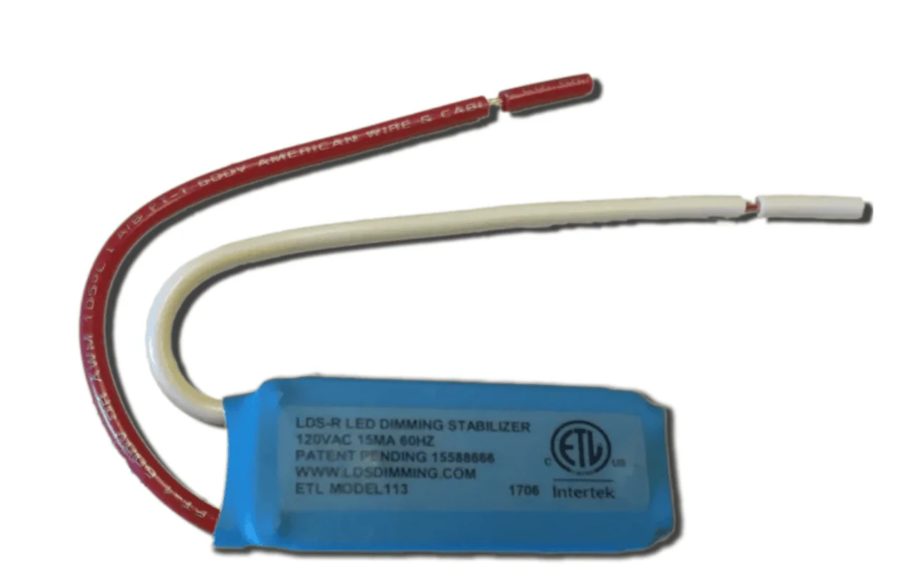

The issue with some LED bulbs on dimmers is the dimmer sees insufficient load, and it gets "confused" regarding what's called the zero crossing of the AC power. The zero crossing detection in dimmers is also susceptible to power line noise and fluctuation. From several other threads having various issues, there is suspicion that the AC to DC inverter inside our Rivians produces harmonics on the power line, and that can certainly mess with zero crossing detection. If it stabilizes with an incandescent in the circuit, it's the probably the issue.
Harmonics are low power and attenuate with distance, so as you mention, a longer run could reduce or eliminate the issue. But that's likely not a realistic solution. A possible solution is installing a loading/filtering device made specifically for this problem.
