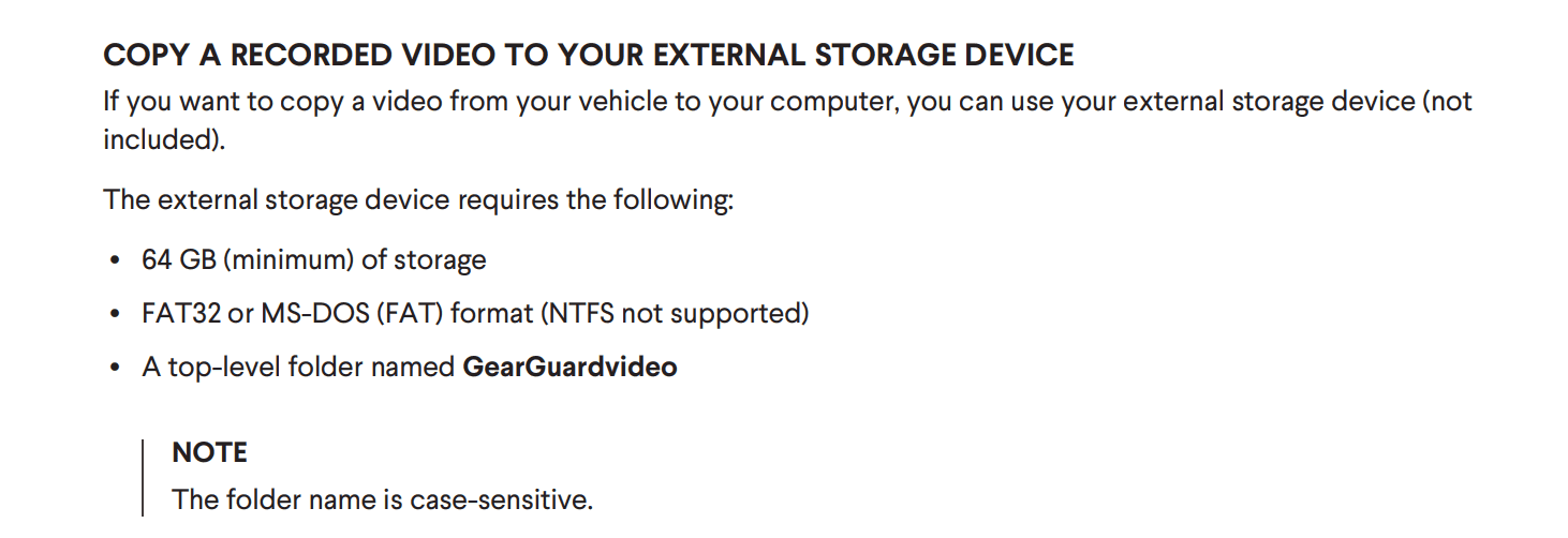

Not having the latest update, I can't speak to it all. That being said, here were the requirements to save GG video. I would say that they are still going to leverage either of those formats.

I tried to transfer my gear guard videos to my USB-C adapter to microSD formatted as FAT32 as recommended, but whenever I try to transfer videos, it says please insert device. I tried both center USB-c ports. I also tried reformatting as NTFS, no luck. The adapter I used works fine in computer, should work the same.

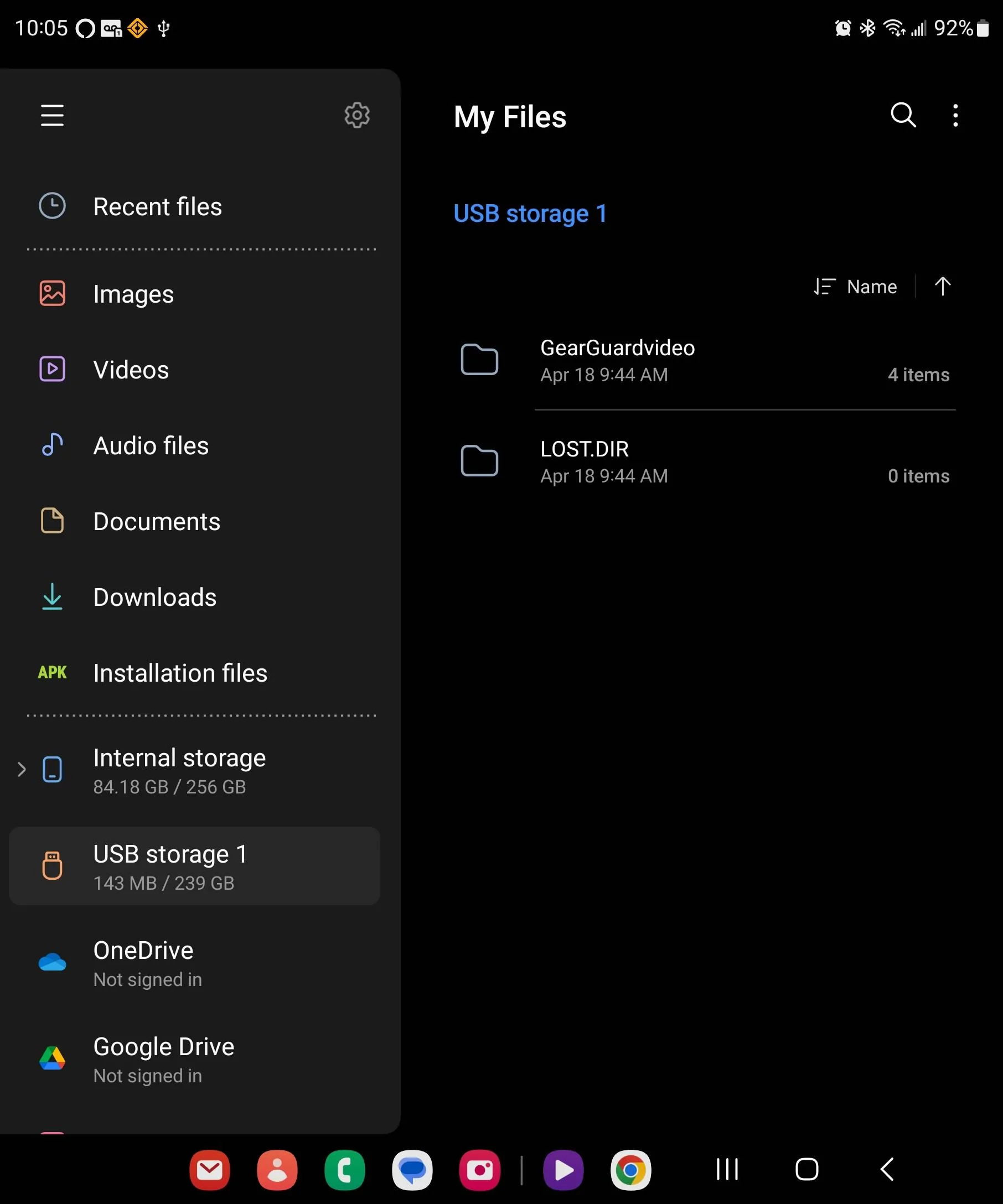

On my drive it needed no formatting and created the folder (probably when I told it to copy a video).
Rivian R1T R1S Show off your dashcam memory card install Screenshot_20230419_100549_My Files
Not calling this the best or even final solution for me. I hadn't considered R/W cycles but I'll be watchful of its life span.

Wait, did you plug this into your phone and copied a video over? or you're just showing us what it looks like when plugged into your phone (after copying a video over when it was plugged into the Rivian?)
What's the process for plugging and seeing? I'm still waiting on the update, so I can't do any of that yet.

I have a Fold 4 so I pulled the drive from my Rivian and stuck it onto my phone's usb-c port, opened my files, and there's the folder.
Wasn't positive this would work but glad to see it populated correctly.
