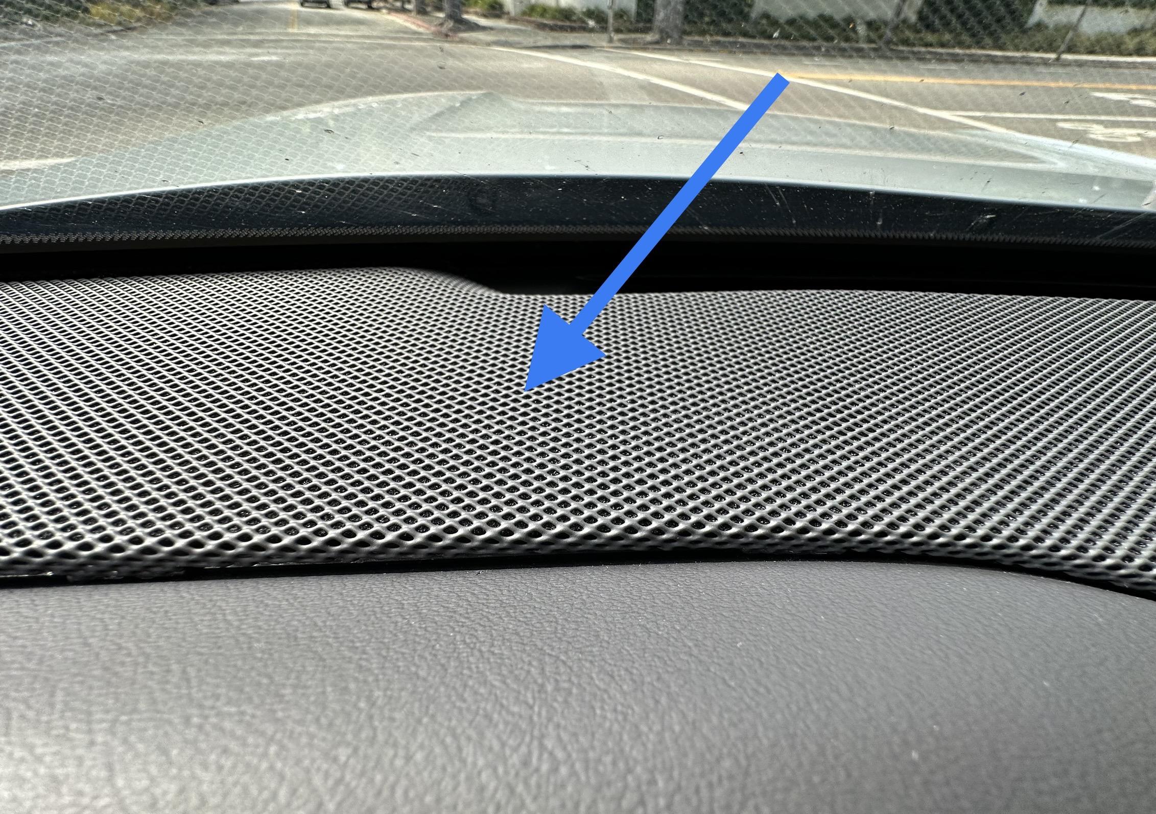

i think I found a relatively easy DIY fix for the rattling that may come from dash’s top grill. See picture.
I implemented the fix and I don’t hear the rattling in my R1.
If you’re interested in trying it out, please let me know. DM preferably so I don’t miss it.
Have you had any other issues with your R1?
