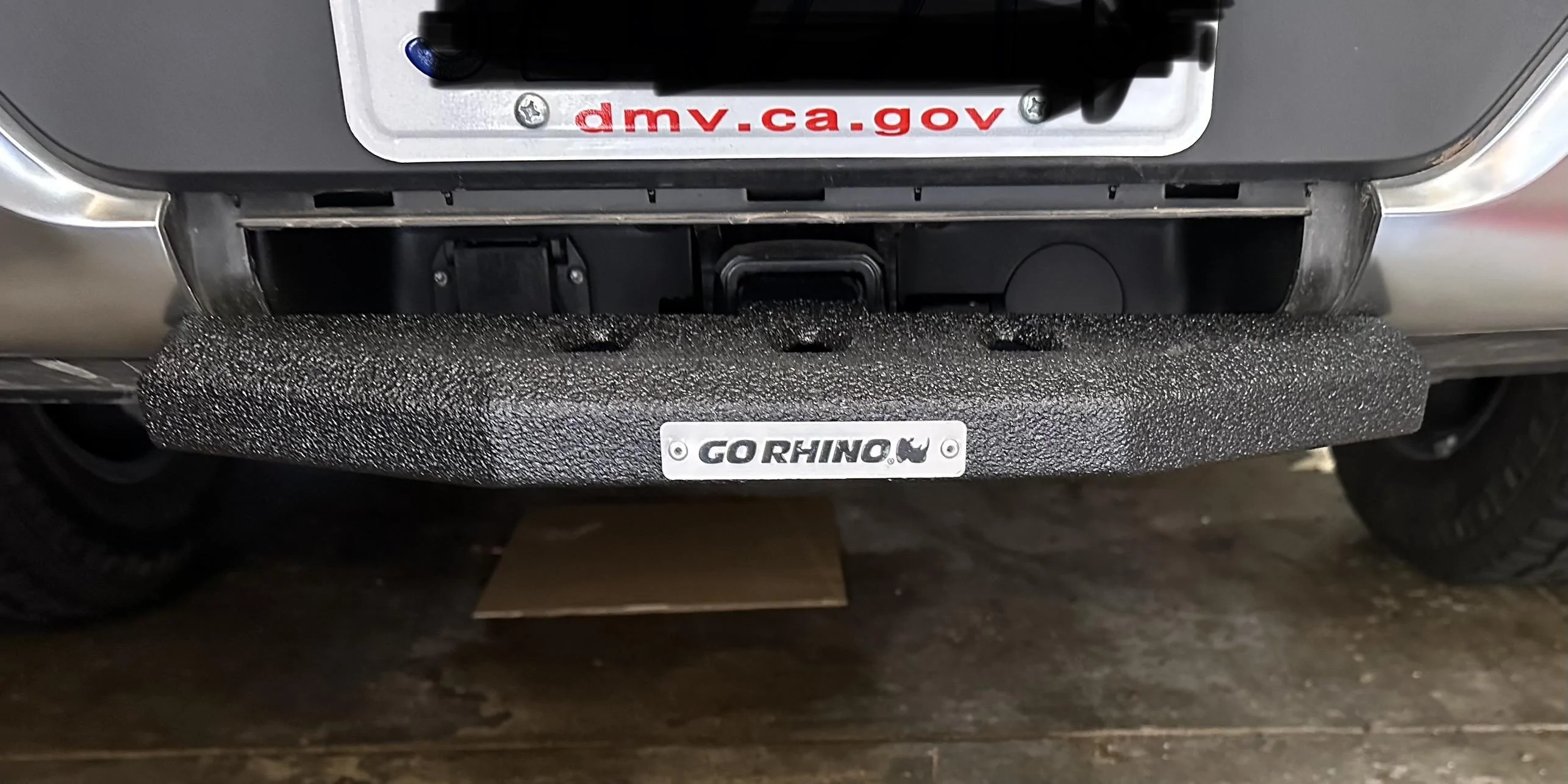

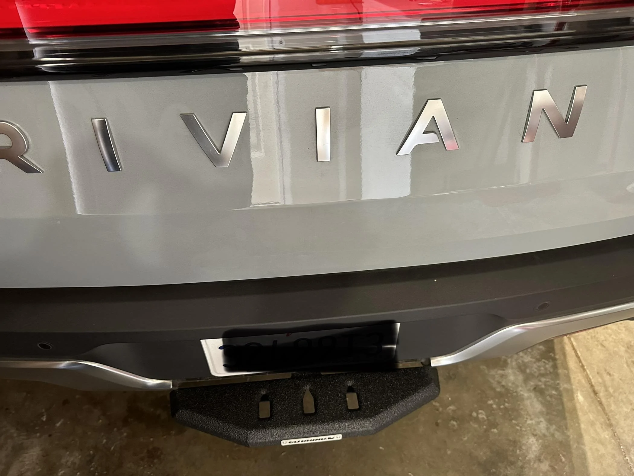

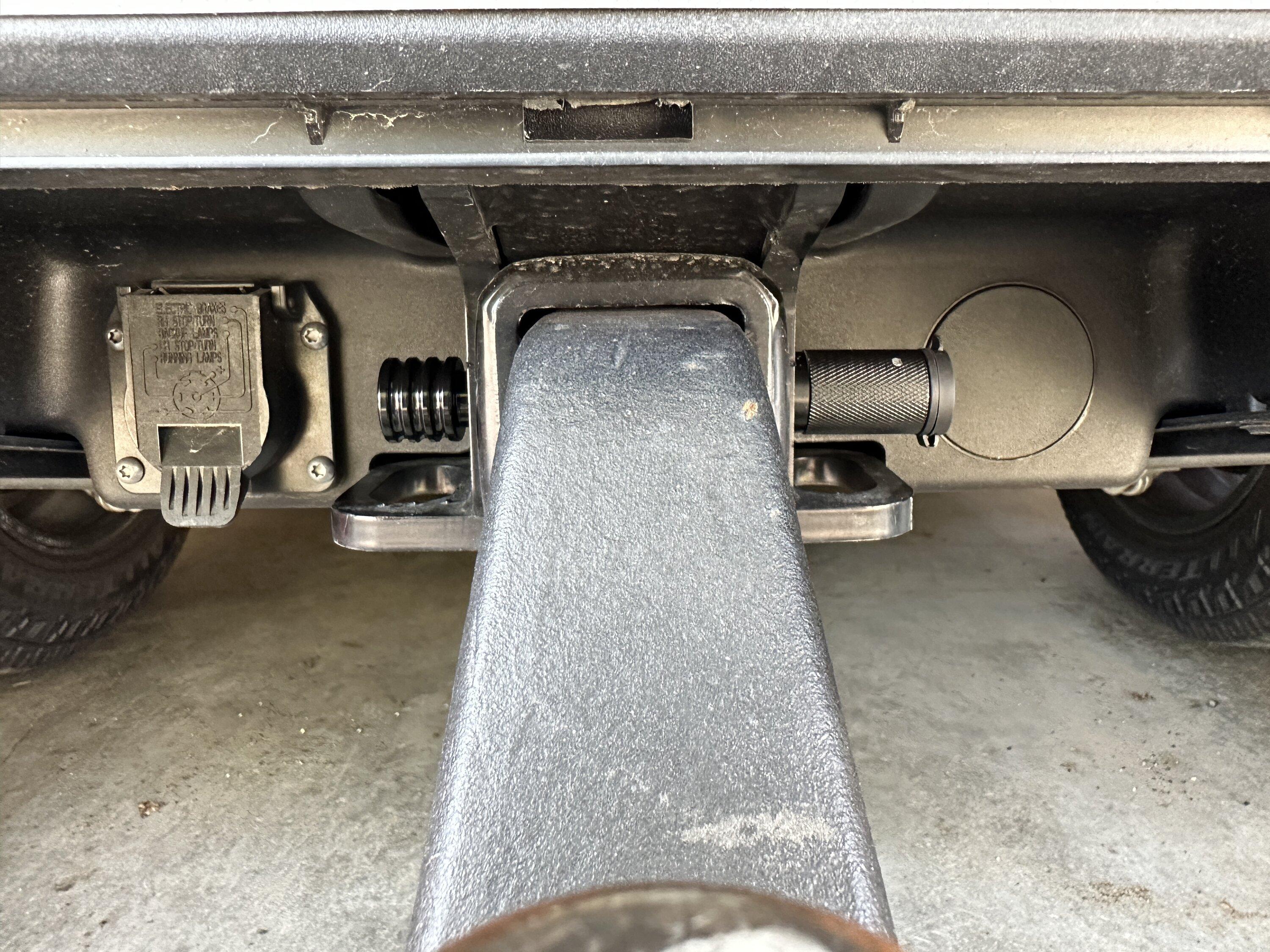

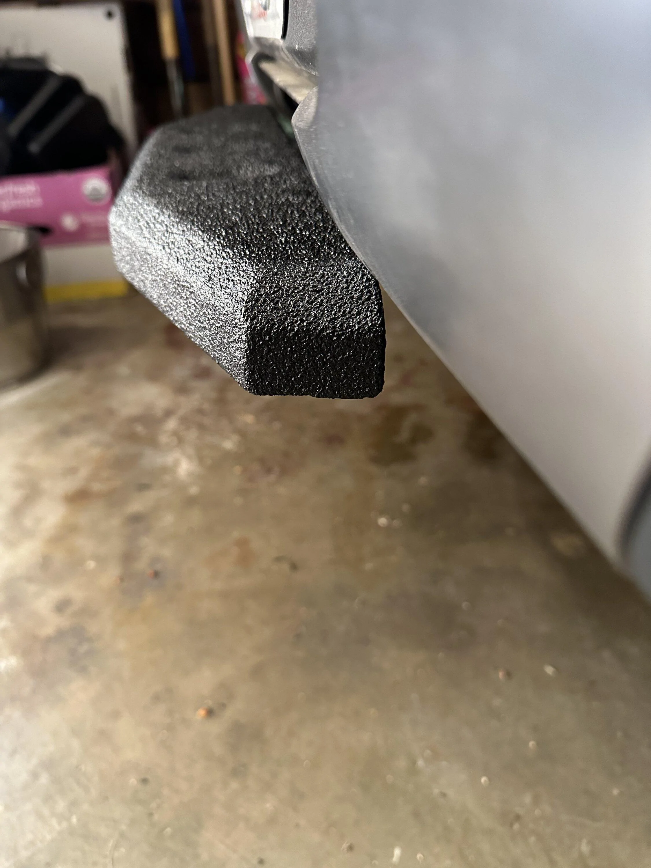

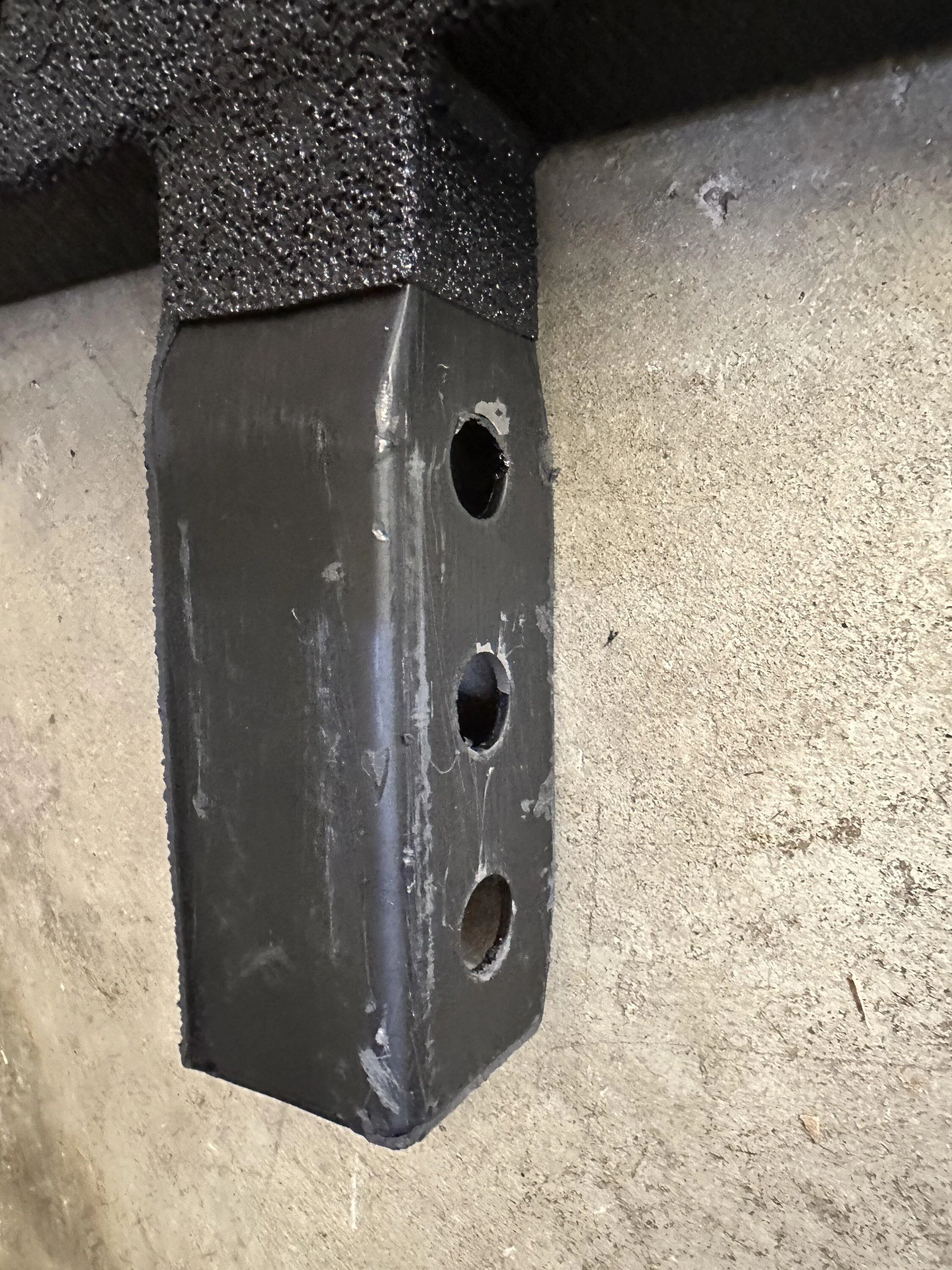

Finally got the hitch step and installed it.
Rhino RB20 step and a locking pin:
https://a.co/d/c7XKT8z
https://a.co/d/3ltcCmb
The step was a bit of a hassle to install. It is completely covered in a rubberized coating. They must dip the whole piece. It is a good looking finish on the step. But I had to shave the coating off the bar so it would fit into the receiver.
Inserted to the 2nd hole it fits flush with the rear bumper. Makes for a clean look but it will likely mark up the bumper over time.

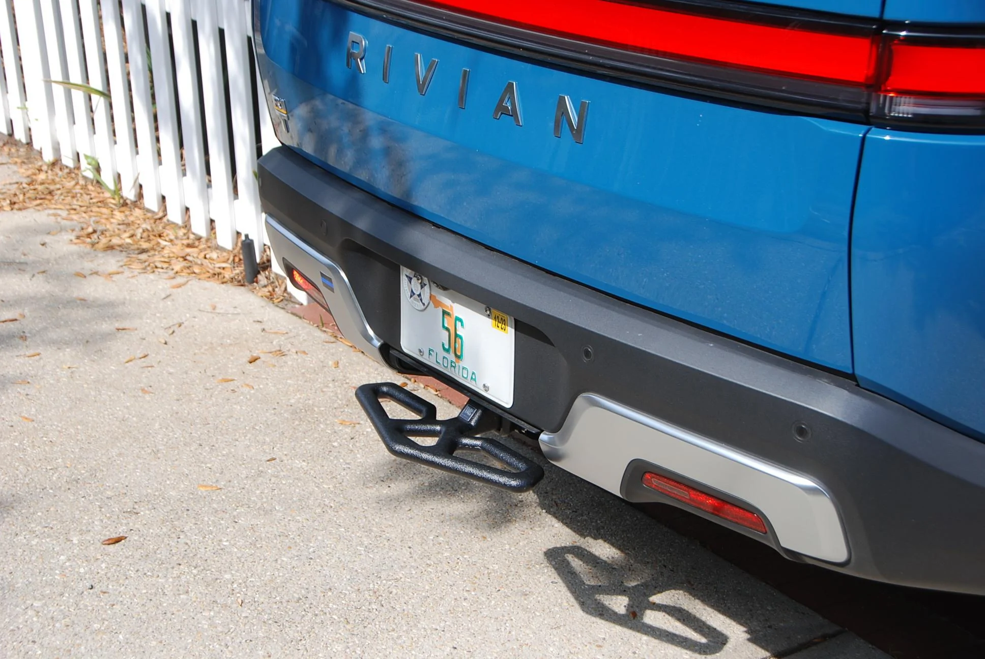

The very first thing that we did when we took delivery of our R1T is remove the hitch receiver cover and put it away for good. We installed a steel step in the receiver to be able to step up on the back of the truck to reach into the bed. This will also help protect the back of the truck from a minor tap to the rear. If you are really concerned about rust, there is a product called Sta-Bil Rust Stopper that We have been using for years to help prevent rust.

I have had a step like this on my trucks for probably 30 years now. I did not realize that a step like this was considered a damage multiplier. To me it's a potential damage reducer for my truck.

If someone rear ends you hard it acts a lever and creates a huge amount of bending force against the frame.

A hitch is not designed to absorb impact like a bumper. If it sticks out and another vehicle hits the hitch and not the bumper, the damage will likely be much more severe. IMO.

Do you still like it? Does it interfere with rear camera?
Love it! I can see it in the cam, but it doesn't necessarily interfere.

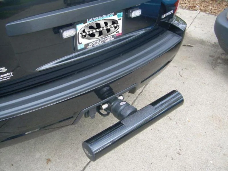

… unless it is one that IS designed to absorb impact. Just received mine this afternoon… but don’t have my R1T yet so don’t know how it will look. Looks fine when I tried it on my Ridgeline. Sticks out just far enough, but not too far. (Not my picture). Spare bumper.com $199. Forum user Macktheknife has one installed on their Rivian and seems pleased.
