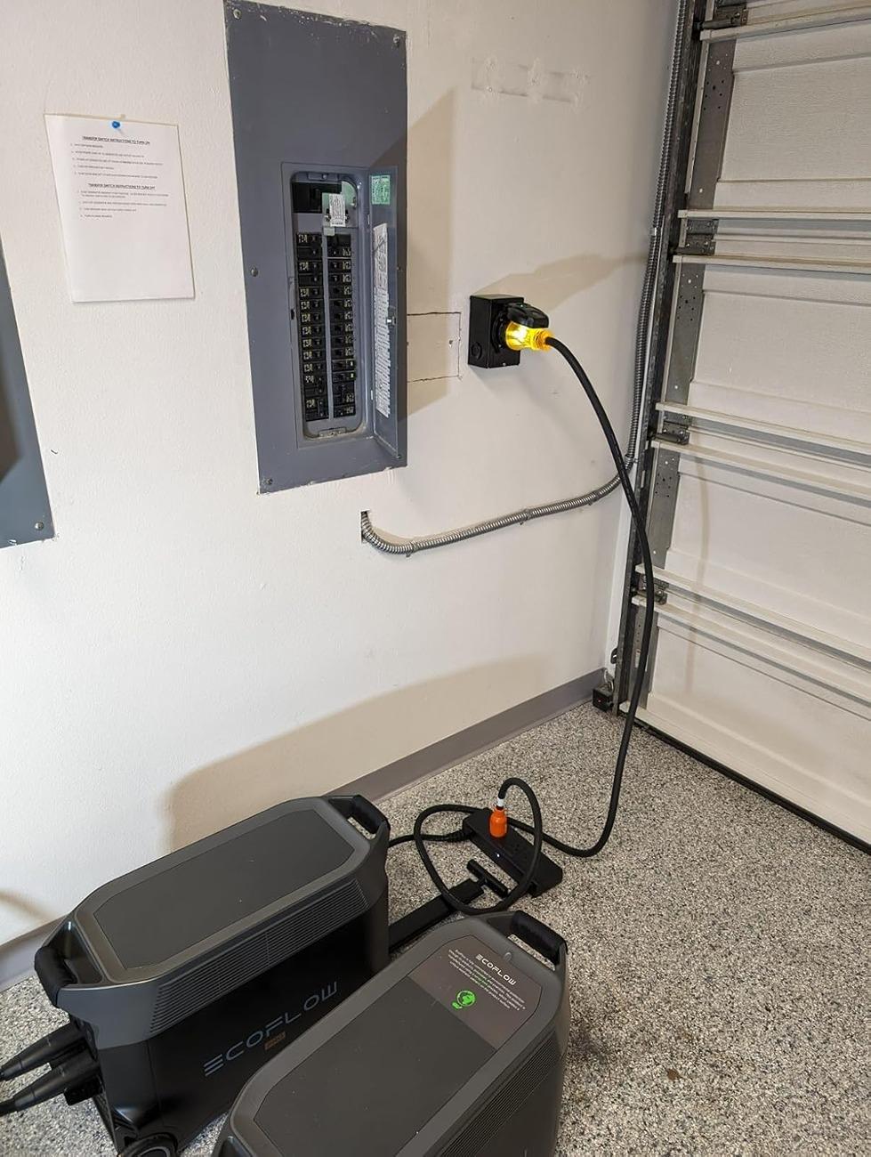

R1S (LG, FE, 20"), Tesla Model X
I've done it with Ecoflows - a few months ago we had a ~9-hour power outage; I plugged the Ecoflows in to the generator inlet (240V 30A) and ran the house off of them. Then I plugged the Ecoflows in to the Rivian's 120V outlet to charge.
(IMPORTANT NOTE from a few months later: 9 hours wasn't long enough to run down the batteries enough that I needed to charge them while they were in use. I re-charged the Ecoflow batteries from the Rivian once the power outage was over. A few months later we had a multi-day outage so I did want to charge the Ecoflows from the Rivian while they were powering the house; that's when I discovered that Ecoflow doesn't like AC input and AC output at the same time. See THIS thread).
Of course the house sometimes uses more energy than the Rivian can supply, but I've got over 20kWh of Ecoflow batteries so that should be a sufficient buffer for any outages we are likely to have around here.
For an extended outage I ccould take the car (and the Ecoflow batteries, if I want) to somewhere that has power, and charge them all from a J1772 station. But yeah, I still eagerly await 240V output from the Rivian!

Interesting. I never thought about plugging a large power bank like an Ecoflow into a generator and run the house on both of them. Is that what you did?

Yup. This photo shows the two Ecoflow control units joined together - each can put out 30A @ 120V, but together they can put out 30A @ 240V. Behind them (not in the photo) are 4 more battery units.
The original generator inlet was outside to accommodate a gas generator; but I had an electrician just grab the wires and hook them up to a generator inlet inside the garage right next to the electrical box.
