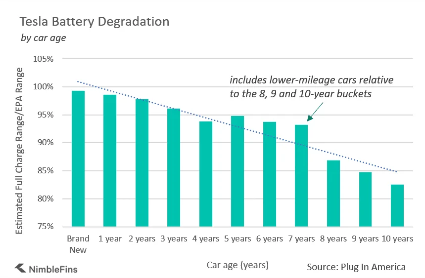

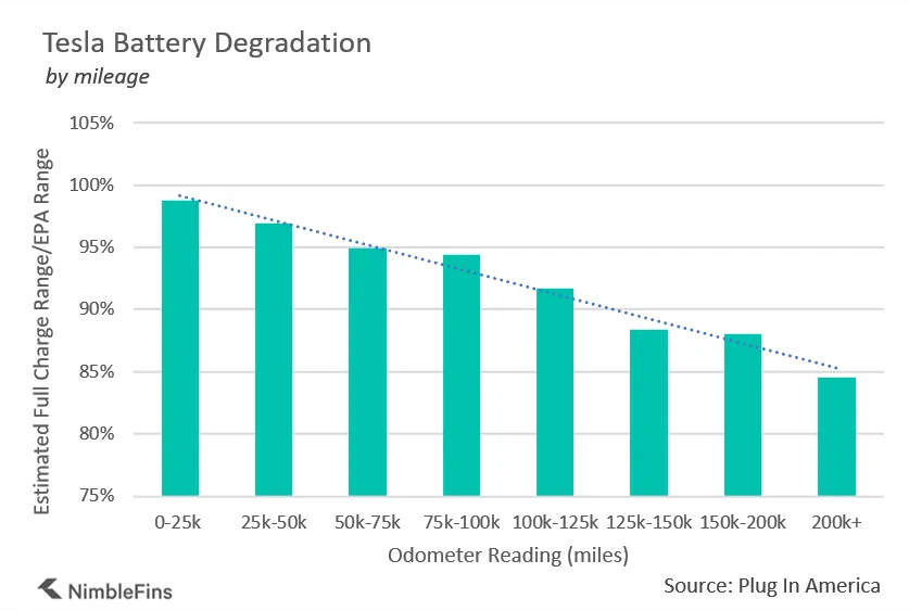

There certainly IS battery degradation, but you should use the vehicle as you need to; I don't need to drive far daily these days, but when I do have a busier outbound week, I set it for 95 - 100%, and when I don't I go to 90%.
According to 9 years of data collected from Plug In America for Model S vehicles between 2013 and 2022, it shows degradation, but not dramatic degradation IMO for the first 100K - 125K miles. See the chart below:
Rivian R1T R1S Unethical charging question? 1725310128910-25
There is a similar chart for time:
Rivian R1T R1S Unethical charging question? 1725310300048-n6
Note after 3 years, there is only degradation down to 96% and at 5 years, slightly under 95%. Not zero, but certainly not significant. My recommendation is to charge the vehicle as you need to, and try to care for the battery as much as possible, because it is the right thing to do. :)
