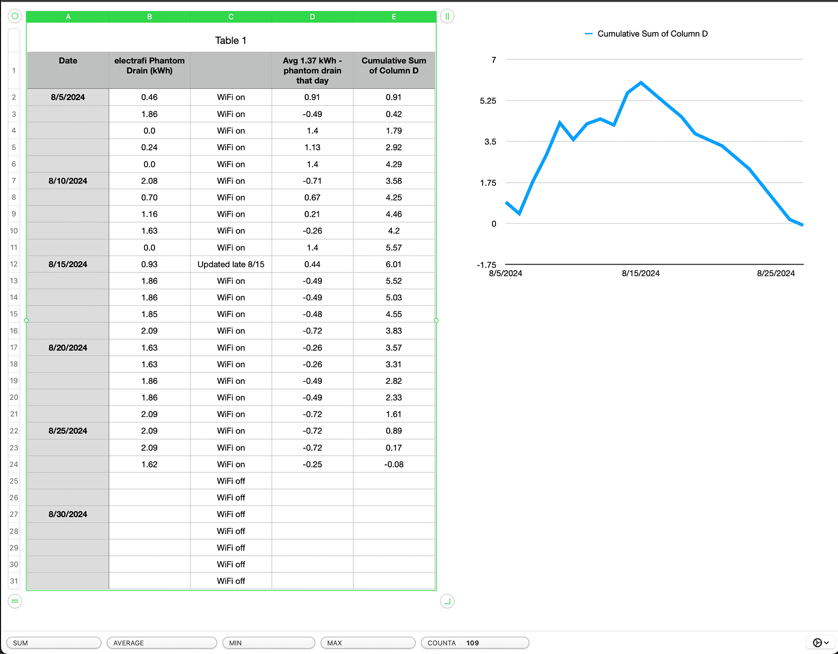

I'll see if I can detect a change in phantom drain after turning off WiFi in the truck.
Before I updated late on 15 Aug, my daily phantom drain was below 1.37 kWh/day. After the update, my daily phantom drain is well above 1.37 kWh/day. I've turned off wifi in the truck, and I'll see if my cumulative sum plot starts going back up again to indicate turning off wifi lowers phantom drain.

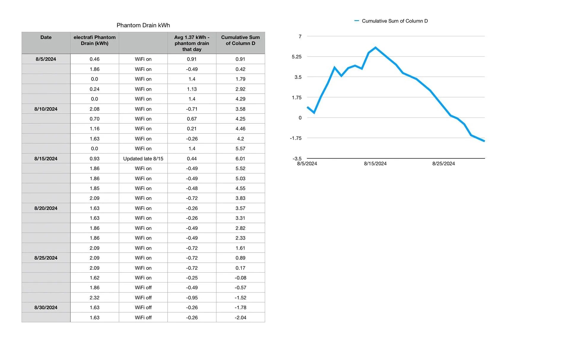

Cycliste
Jul 7, 2023
1,195
1,678
Solano County, California
Amateur aero weenie
I don’t think turning off WiFi lowers phantom drain. The slope of the curve should have gotten less steep downhill.
