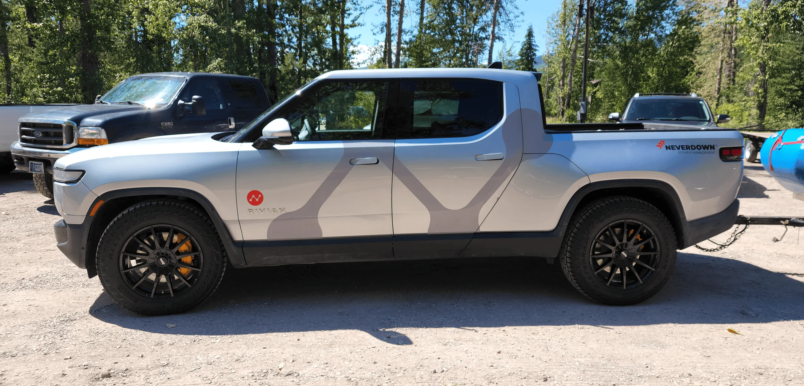

I swapped my truck from 22s to aftermarket 20s with Pirelli Scoripons in the stock size. My dash image (and I'm guessing my calibration) was displaying the 22s up until the last SC visit in December. When the truck returned it was showing a picture of my LA Silver R1T with 20" dark wheels. This was the closest, I would guess, to what's actually on my truck.
OP - This was done in Bellevue and as you (ID) and I (MT) are closest so that SC, maybe keep that in your back pocket in the event that your truck ever visits that SC...
For what it worth, your tires look massive! Do they fit in the wheel wells in standard or low ride heights?
You got the American Racing wheels!
Those are back ordered everywhere. I was able to find three of them, but not four. These are the only non-OEM wheels with +30 offset that donā€™t look terrible (to my eyes).
Congrats!
They are stock 20 size. 275/65R20's. No rubbing so far.
